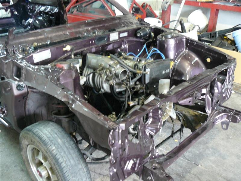

Anyway, I've now acquired a new AE86 and going to keep this thread updated with it's progress. Things get done a lot quicker when you do them 10th time round.
Started out as a stock red ADM, we took it back to the workshop and stripped it bare:
Interior was stripped with dry ice:
Unnecessary holes in the bay were welded and filled:
Interior and engine bay were painted (the color didn't come out right, it was meant to be more on the gunmetal side, but too late now haha):
We used the engine / driveline from my brother's damaged AE86 as a donor and binned the shell:

We fit the motor in, then Nathan (sprinter86) came around to clean up the wiring mess (did a really good job of it, hid all my wiring):
Here's how it sits now:
Will add more updates in the next few days.

Most of the mods we do have simplicity and neatness in mind, so a lot of parts have been removed, or relocated to a position that can't be seen.
Car
- 1983 ADM Toyota Sprinter
Interior
- Removed all interior trims / sound deadening
- JDM dash / cluster
- Brand new black carpet (front half)
- AJPS drift button
- HKB boss kit
- Battery relocated to rear seat
Exterior
- Brand new kouki Levin front bar
- Shaved antenna, rear wiper, rear wiper sprayjet, boot keyhole
- Handflared front / rear guards
Engine / Management
- JDM RWD 16v 4AGE
- Quad throttle bodies (to go on after registration)
- Wolf 3D
- JDM fuel tank
- Relocated fuel filter to transmission tunnel
- Relocated radiator overflow to behind frontbar
Suspension / Brakes
- FC RX7 calipers
- AJPS FC caliper adaptors
- R32 brake master
- Custom brake lines to suit
To do
- Redlines
- JDM headlights / parkers
- Ducktail
- Coilovers
- Fat wheels
- Paint
- Registration
