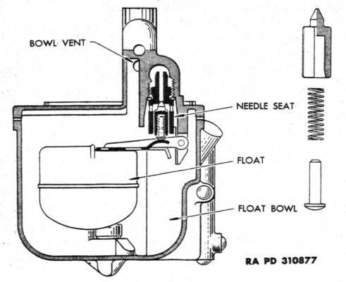

Fuel bowl float in the carby...
Or more likely - "needle and seat" in the inlet to the carby need looking at / replacing...
Another reason why stock Aisan Carburettors belong on the bottom of the ocean.
Ask me all about fixing carbies on the side of the highway 5km outside of lismore at 2am in the morning...
Not fun
Not the same as your carby, but the concept is the same
