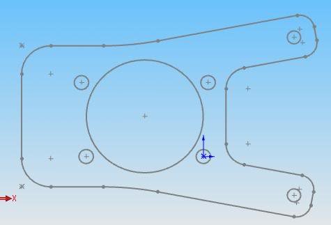

    i got a pair of buddyparts rear caliper adapters to suit T series, redrilled them to suit F series.
    used jdm calipers with s13 rotors.
    used standard ae86 handbrake cables.

    I use that. Runs S13 calipers and discs with S13 cables up to splitter.
