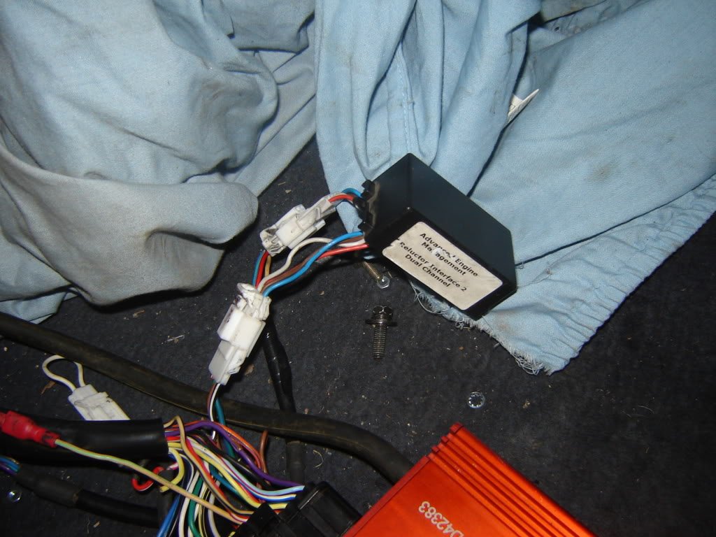

    also, with the ecu, its has a little black box wired into the loom. with that connected when the ignition turned on, the fuel pumps continually run, but with it disconected, fuels pumps run the turn off (like normal). but i have no idea what this black box is. it says on it reluctor interface 2 dual channel.
    i have nfi what it is or what it controls.

    The black box is a helper for the ignition pickups. People have had problems with Wolfs on 4AGEs getting the ignition inputs running well and apparently that box helps (I've no experience with them and never have had troubles on my engines).

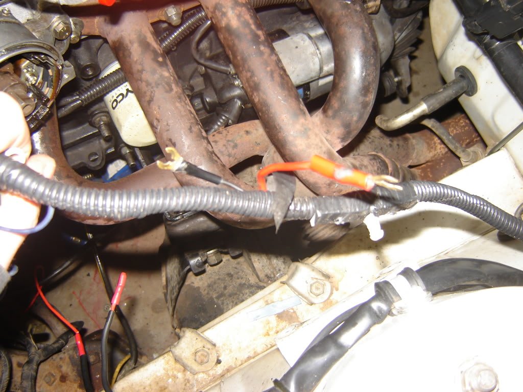

    hey guys, i know this will sound stupid, but going over the car again and noticed that the the negative and positive wires in the origanal loom for the coil aren't hooked up to anything and the guy i brought it off said he wasnt sure if they were hooked up or not.
    should i be hooking these up to the coils, or not?

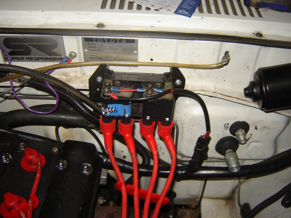

    here's a few pics:
    the coil's are denso
    little black box i was talking about
    two wire's for the original coil, which im sure to do with now?

    Original coil wires are for original coil. You now have two coils running electronic ignition where it would originally have been a coil grounding out with the mechanical points.
    Anyway, doesn't matter because the ECU doesn't know the motor's turning.
