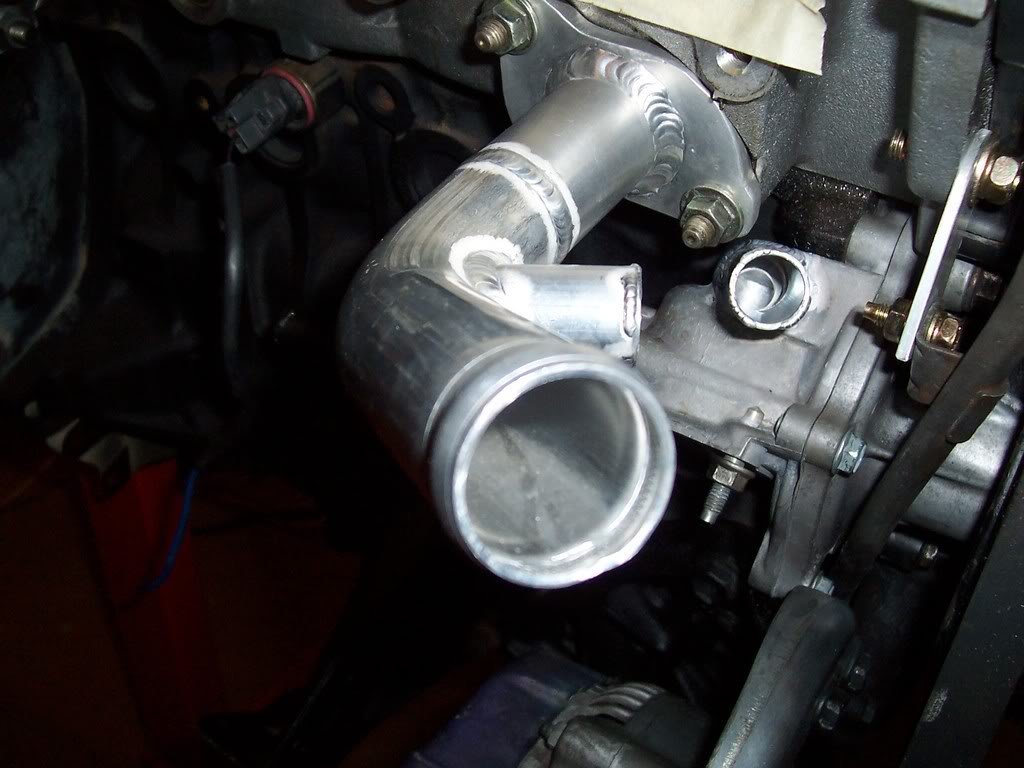

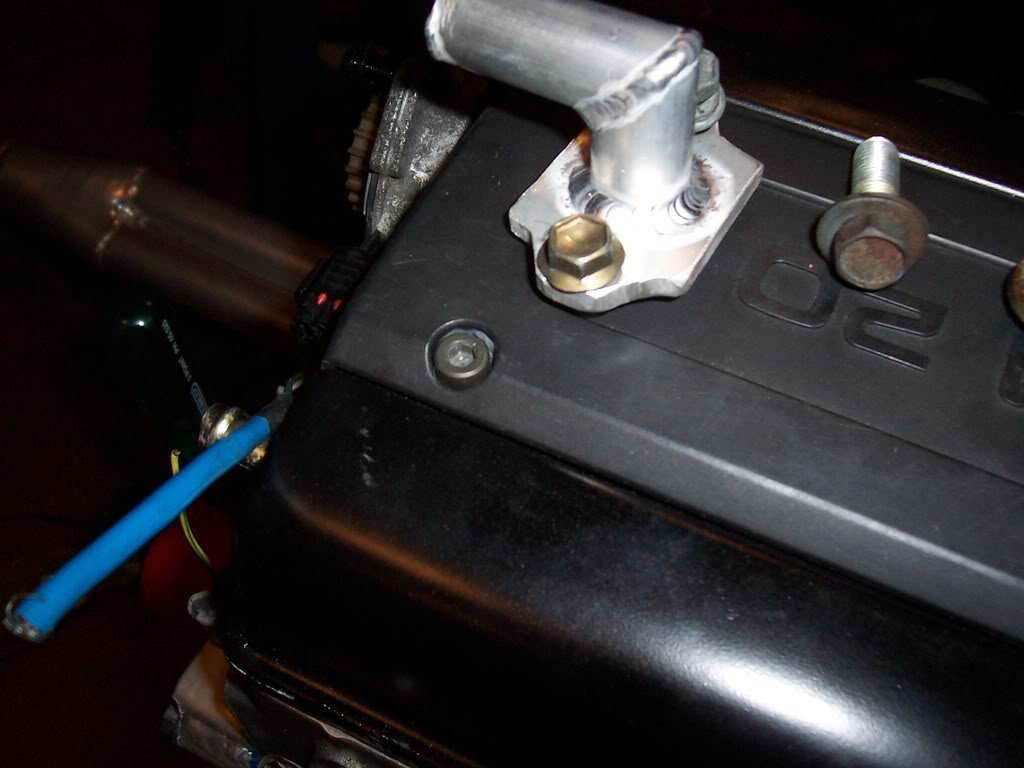

    This is my RWD set up for my 20v, pretty self explainatory and looks and works
    as good as any factory setup. I recommend copying it if you are undertaking
    the conversion.

    All factory radiator hoses line up perfectly

    i like the way you did your top hose outlet. i doing this conversion at the moment, and thats all i have left to do. i was planning on doing something similar.
    i also noticed the back pipe you just flipped a 4ac pipe and bolted it back on. i had this idea aswell. did the pipe foul on anything? atm mine doesnt seem to but i haven't put everything back on the motor yet, and i haven't figured out why more people don't do it this way.
    definetely the neatest 20v water systme conversion i seen to date!

    Sutherland
    485
    H8CHI6KU, I cut about 6 inchs off that pipe then put a tab on the end to hold the hose on.
    I think it was just easier to put a return hose to it being shorter.
