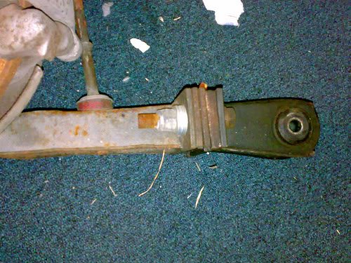

    anyone got pics of lca? i cant seem to get any pics of any lca, i need some pics to do some comparisons

    i have got a set of ke30 adjustable chilling and they are any length u want them to be i will get pics up asap for a reference
    the dyno pull to 300rwkw

    ke30 and tt132 (xt130) are identical from the ones i've pulled from cars. measured my ke70 lca at 290mm and ke30/tt132 at 300mm. whichever way you measure theres about 10mm longer there. bolted up with a wee tweak to suspension angles.
    my front suspension consists of ma45 (jdm) strut with std 10" solid disks, ae86 p/s arms, tt132 lca, ae92 shock spaced down, makita springs. i gained -1deg camber each side and also +1deg on the caster when wound all way forward which is now 3.5deg. once i get rca's in there it'll probly bring it back to vertical so then camber plates should hopefully get my -2deg.
