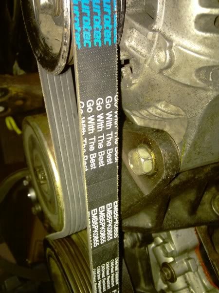

i wont be using the a/c so .. finding a alternator belt was biatch .. did something like 4 runs to the parts shop . Auto Excel boys down at Bonnyrigg were very helpful ... go see them next to Aldi and KFC.
for anybody who needs the part number its :

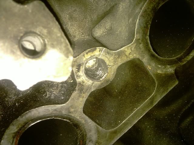

so the engine was 90% done and only thing left was to tighten up the exhuast manifold bolts.. easy right ... wrong!
this happened :
previous owner striped one of the studs so it wouldn't bite ... so i figured easy fix .. went out and bought a tap and die set .. taped in a new thread , and it was ready .. from there i should of stop and went to bed . but me being a impatient prick .. i went looking for a stud that would fit .. after an hour of swearing i thought stuff it ...i'll just get a bigger bolt and force it in ... got my rattle gun out and started forcing it in .. after a couple of minutes it looked good . it was going in and need a little more ... that little more cracked it ... lesson: don't do what i did and take it to a pro
which i ended up doing ... which sort of work out ok for me .. i had 2 options really ,
1/ he could try and weld it and put in a sleeve and tap a new thread... but there was no guarantee
or
2/ change the head .
i opted for the new head ... simply due to not wanting to take the motor out if the stud failed on me once the car is running
funny enough it worked out ok , Sprinterman my engine builder said that the original head suffered from alot of heat more then normal and wouldn't of lasted very long anyways no more then say 6months or so and that whoever built the motor last got happy with the gasket glue. some of it had broken off and was blocking the water galleries ... that night i learnt alot about gasket glue and the damage it could do if it has been used incorrectly.... apparently it could cost you a new engine... =P

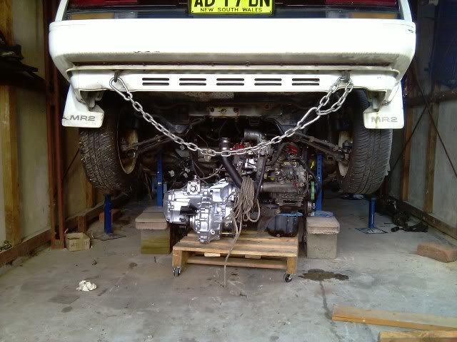

so i built a trolley from a small pallet i found and bought the wheels from bunning .. hopefully this will help with the installion this week ...

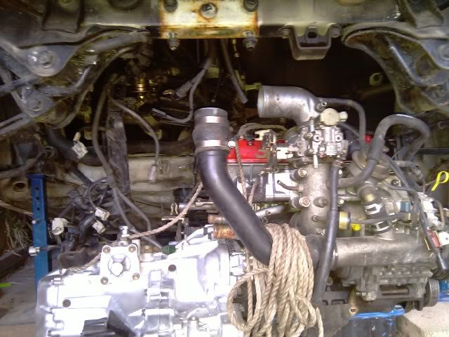

motor and gearbox reunited

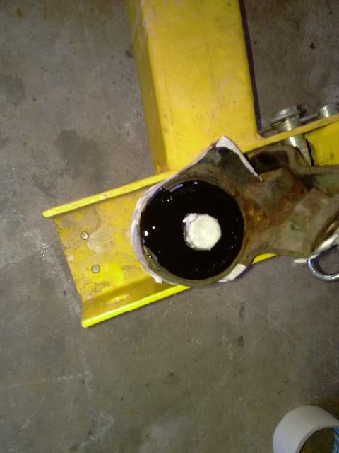

i choose 3. simply because im on a budget, the engine mounts aren't totally goneski so with some help they should last me until i get funds to buy new ones. plus this car wont be a daily and will only really be driven once or twice a month mostly to the track and back. so with that in mind i got this today :
before anybody comments that urethane is soft. this stuff is rated at 80A.. engine mounts are normally rated at 70-75A .. i was going to go the 95A stuff but opted for the 80A , just because I'd like to keep my teeth.. hehehe and 4ages don't like super stiff engine mounts ..
and did this :
then this :
then mixed some urethane up
and then filled them up :
dry time is 48hrs with 100% cure at 7days .. so thats perfect for me .engine will go back in the car on saturday ..

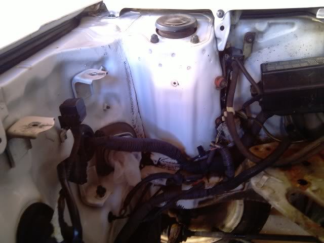

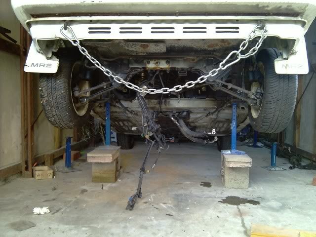

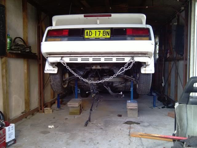

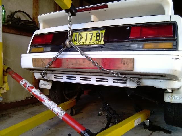

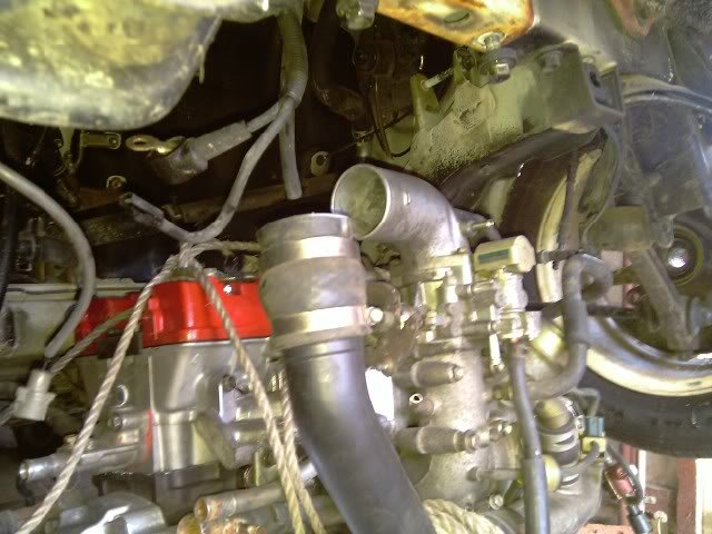

so last weekend the engine went in .. was pretty straight forward..

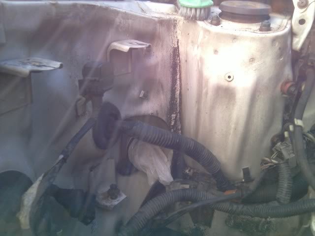

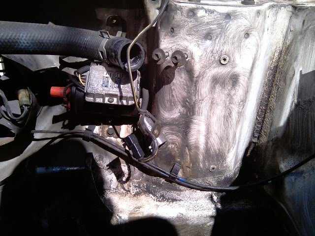

thought i give it a clean first since the motor was out .
car up and motor in
forgot to take photo of the motor in .. but it is in ... hehehe

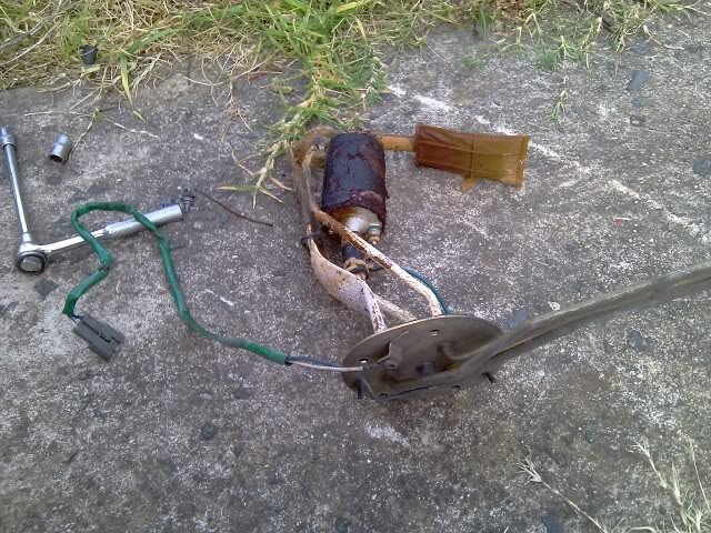

fuilds are done .. wiring is done and fuel in ... battery connected and went to crank her and she got a good crank , plenty of spark but no fuel ...

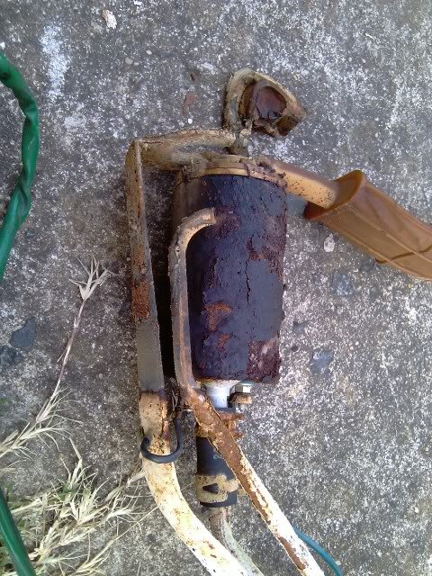

this is why :
just pulled the tank out about 15mins ago.. OMG!!! i have never seen such a farked fuel pump in my life ... funny thing was that the fuel tank was full of petrol .. super old petrol but none less .. i know because i pulled the fuel tank plug out and it pissed petrol for a good 5mins all over my frecken arm ...
maybe it was already rusted & farked and someone thought all it needed was full tank ..
ANYWAYz i need a new pump and a working fuel gauge sensor (thats rusted too) ... any one know how i can clean the inside of the tank with out cutting her open ??? will water and vinegar work

dose the rest of the tank look like the pump?
let tank dry out completely for a coupla days then give it a few knocks all over so it will loosen up any flakes of crap in there, then try to flush/ wash out with diesel or something....... worked all rite for my old ke70
hey guys... can report it came out awesome with a little help from nature ... just waiting on the new pump before a proper update with pics ... boss (ex race car mechanic ) reckon i should also clean the fuel lines aswell SOOOOooo ... thats gonna get done aswell ... i was hoping to hear her start but i guess it can wait ...
