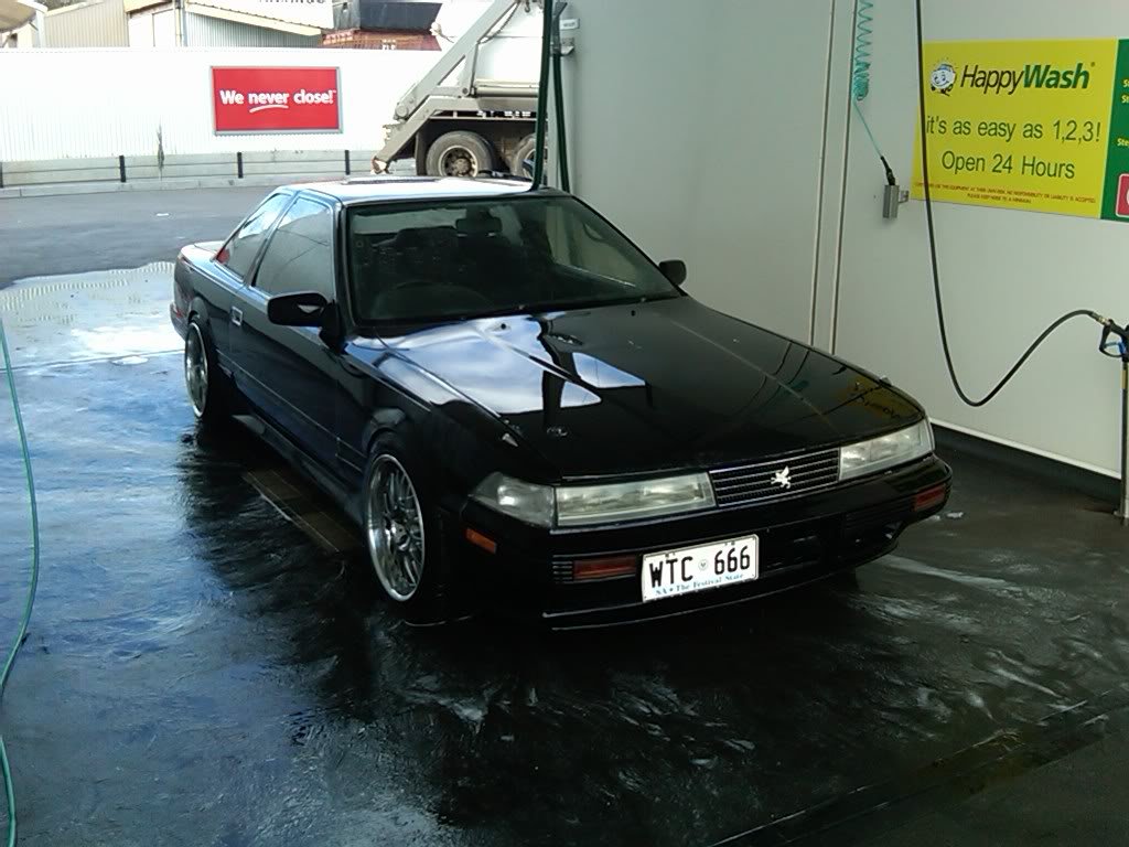

    Figured it was time to reveal what had taken the place of my 3SGE Beams powered 86...
    Body
    OEM Sideskirts and rear pods
    Interior
    Microtech DASH unit
    Pioneer H/U, 4 and 6 inch speakers
    Engine / driveline
    2JZGTE, Fidanza cam gears, GReddy Pulley Kit
    HKS filter, 4 inch Stainless inlet pipe
    Trust T78-33d turbo on HELPS exhaust manifold, HKS GTII 60mm gate with screamer
    Custom FMIC kit with stainless piping.
    Bosch 044 fuel pump, 2lt surge tank, SARD adj. FPR
    3 inch dump/front/decat pipe, 3 inch stainless exhaust with 5Zigen muffler
    Microtech LTX-12 - 304kw @ 15psi
    R154 5 speed, C's short shifter, braided clutch line
    OS Giken Twin-Plate clutch and flywheel, push/pull converter
    Welded diff, 4.55 CW+P
    Custom Alloy radiator with 2 x 12 inch thermofans and shroud
    Wheel and Tyres
    Work VS-XX 17 x 9.5 +24 and 17 x 10+24
    Suspension setup
    Cusco ZERO2 Coilovers (20KG front/16kg rear)
    Whiteline rear swaybar
    Modified hub ends and LCA's for increased lock
    So far mods have been -
    My 18 x 9 +35 and 18 x 10 +35 SSR Kampter wheels which were bought for my old soarer before it got written off
    2 x Black Recaro SP-G's on Nagasia Auto Low-down rails, Takata 3 inch 5-point harness x 2
    Suede Momo MOD08 wheel
    APEXi Boost/oil temp/oil pressure gauges
    13 row Earls oil cooler and Powersteering Cooler
    Super-Now cutting tie rod kit
    Arizona Performance JZA70 Willwood big brake kit, Rear Braided brake lines, Cusco Master cylinder stopper
    GReddy Profec B SpecII EBC
    ATI Harmonic balancer
    6000K HID Kit
    Mods to come will be -
    20% Tint
    RDA rear slotted rotors and Project Mu D1 rear pads
    RMR Dual Feed Fuel rail and 1000cc Injectors
    HKS 272/9.3 cams
    Another 044 pump and Dual outlet 5 ltr surge tank
    New tune
    repaint the car in Subaru Forrester metallic green (Engine bay already done)
    That should do it. But really, Im not to fussed with modifying it ATM. Im spending a lot more time driving it into the ground.
    Thing's a fucking animal to drive, has no trouble baking third and 4th. Made 305kw's @ 17psi, With another pump, injectors and cams it'll make 450 at the rears, but at the moment 300 is HEAPS.
    Havent driven it for a few days as Ive completley gone through my rubber stash. Pickup new tyres tomorrow arvo sometime. And then drive tomorrow night.

    ATM About 3800-4000 rpm is full boost. Starts ramping really hard from around 3400 - 3500 or so. Was really surprised how hard it hits.
    From what I can find out, most guys using the same turbo are seeing 4500rpm + at the same boost level... so Im doing pretty damn well already. It's all in the manifold though.
    Looking at a 15cm exhaust housing to put on as well, but not too fussed. it's actually fairly easy to keep on boost.... lot harder to keep in a straight line though.
    Most probably.
    BRAKES! It's kinda hairy to stop at warp speeds.... hence why the big brake upgrade for the front. Aside from that, not really atm. Im just enjoying driving it.
    Hopefully have it on the dyno before christmas to tune with the EBC, but not not too fussed if I dont. It's got everything it needs... except tyres with tread.
    Going to put on my oil cooler kit ASAP and possibly a lower temp thermostat, seems to runa bit hot. Sits around 92 degrees when thrashing hard.
    Yeah I know! There are ways and means, but engineering is on the table at some point. TBH it wouldnt be that hard... just costly and time consuming. Trying to keep it on the DL, seems to go under the radar a bit believe it or not. Just particular about when/where I drive it, but if it happens it happens.
