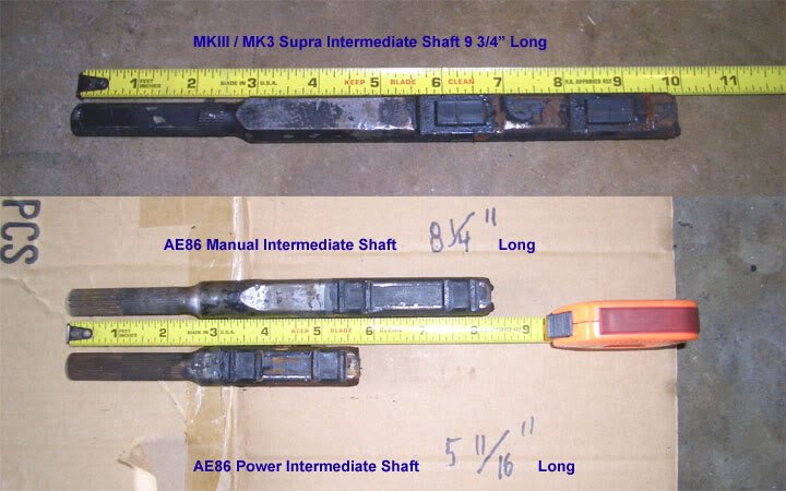

    MKIII supra intermediate shaft will solve your problems:
    Andrew
