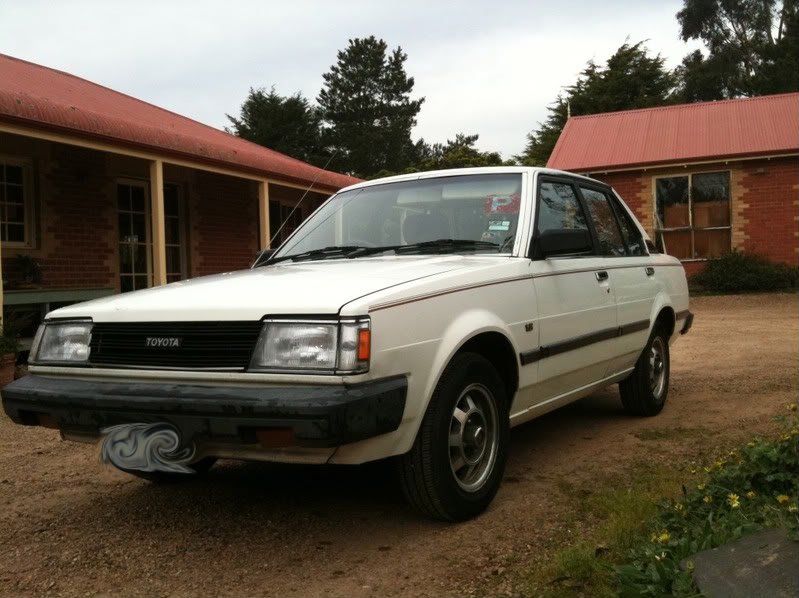

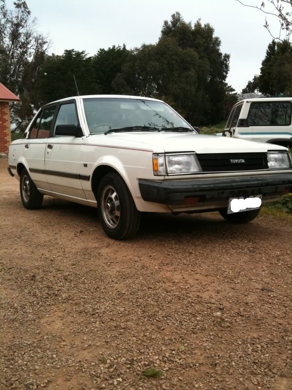

    So i have finally decided to make a build thread. So here goes...
    Its a 1984 AE71, originally a stock manual 4ac. Got it from a member off here. When i got it rego'd:
    Now:

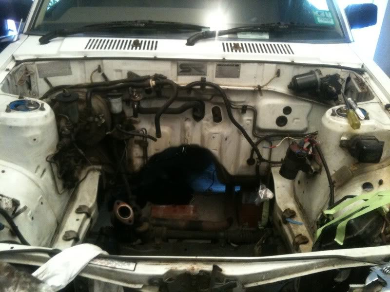

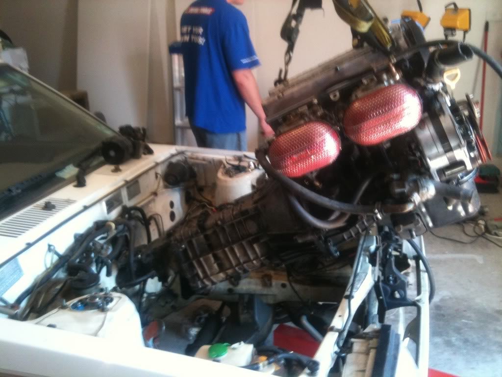

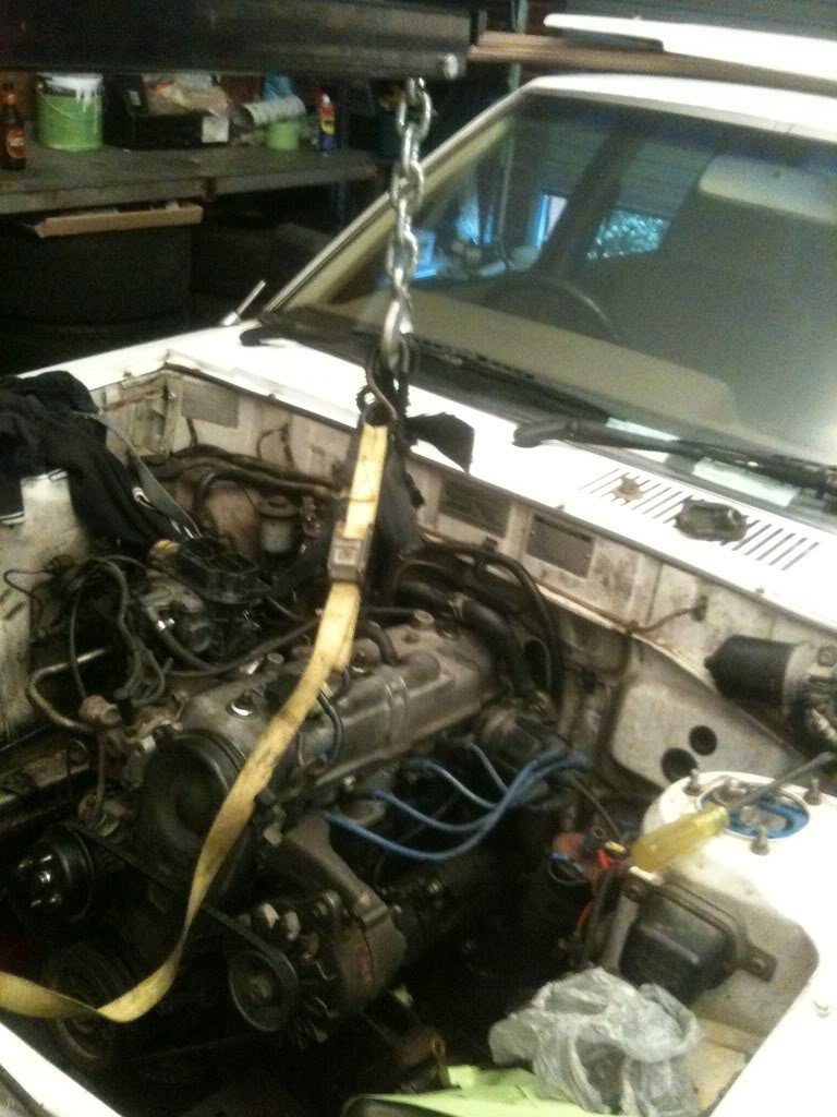

    Engine:
    Bigport 4age, with twin 45mm webers
    ebay adjustable cam gears
    4age oil cooler, with remote filter mount
    Low pressure fuel pump mounted in the bay
    Adjustable fuel pressure reg
    cheap copy 4into1 extractors, heat wrapped, 2-1/4inch over diff, with a hotdog and another similar sized straight through muffler

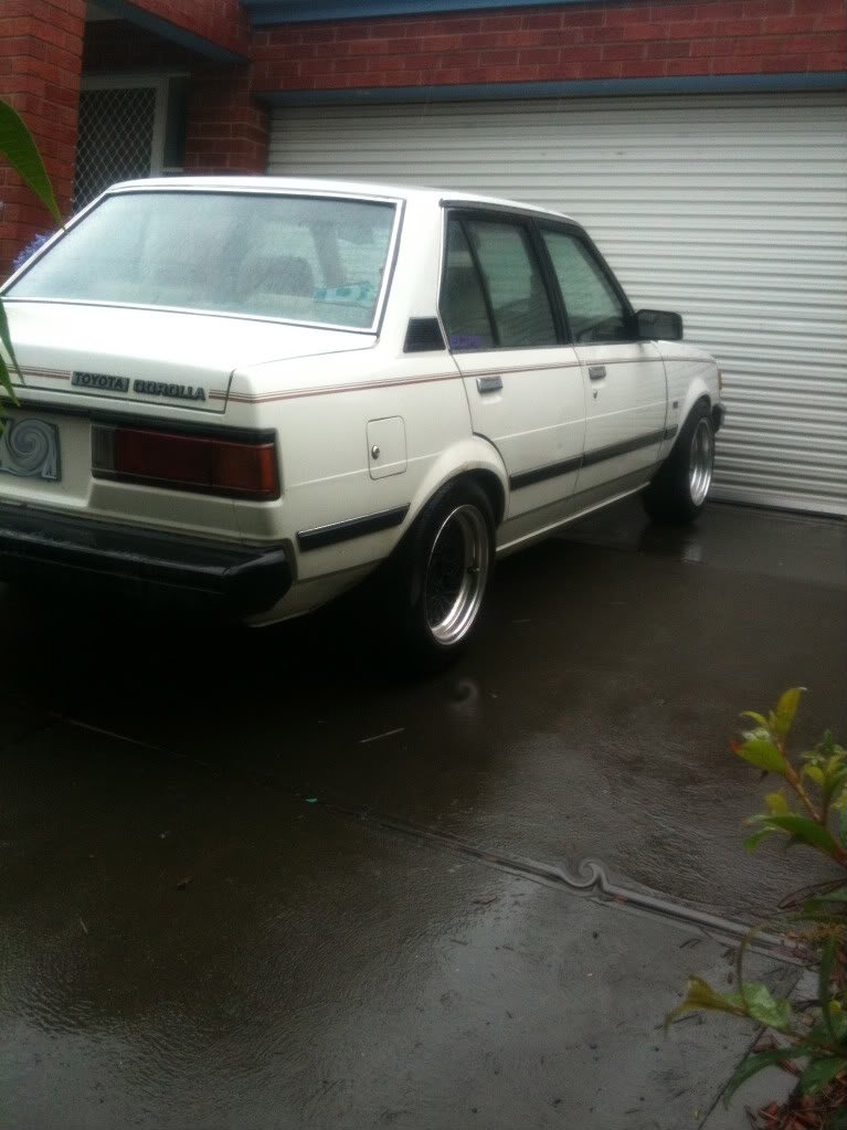

    Other stuff:
    SSR Starsharks (bought through otomoto)
    Fronts: 14x7.5, 0 offset, with 185/60 re001's
    Rears: 14x7.5 -8 with hero 185/60
    Also some SSR meshies 14x6.5 low offset with some 185/60's

    Pics:
    Dirty!
    If it looks weird, it may be because the car is on a driveway that goes up then flattens off
