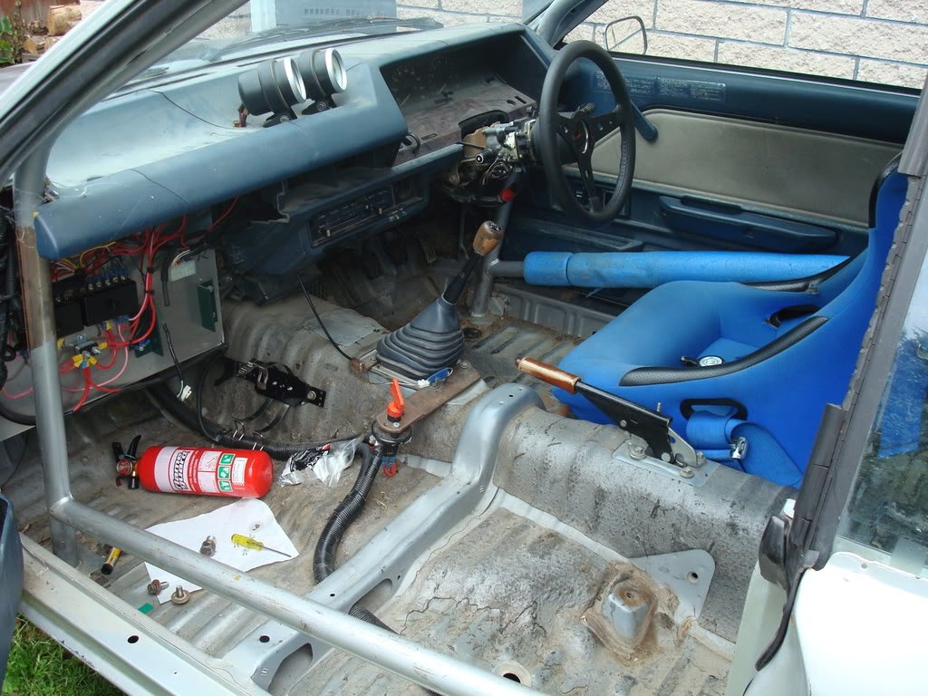

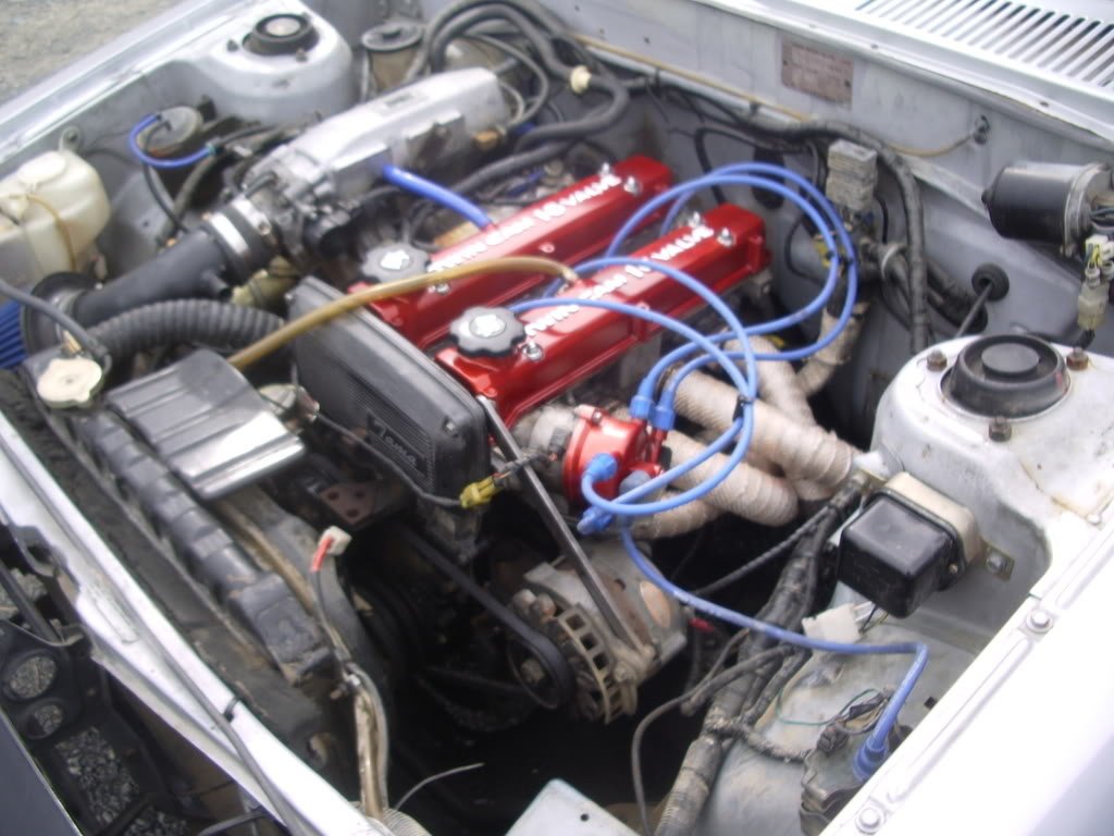

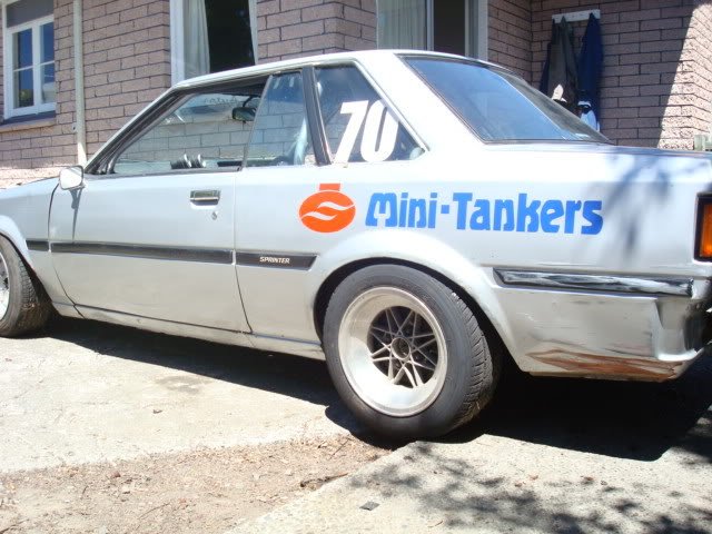

heres my drift hack ae70
Engine: 4age blue top, headers, filter, 30 degrees base timing 75 rwkw avgas
Box: K50, mildly heavy clutch
Diff: 7.1" E series lite ace 4.3:1 locker

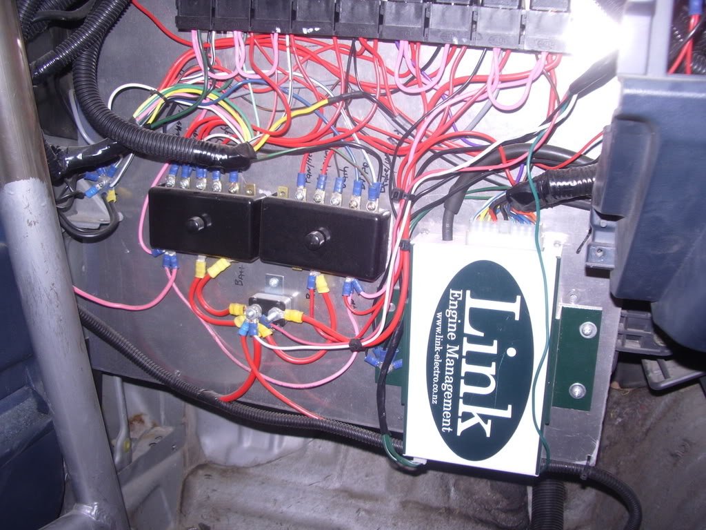

ECU: tuneable link G1 V5
Suspension: Front: adjustable LCA, D2 adjustables, strut brace
Rear : D2 shock and spring in 1 adjustable, adjustable panhard

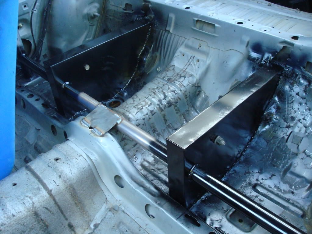

Body: full 6 point welded cage, equal length 4 links
Coming very soon (have all parts in donor ae85) TRD front suspension & LCA (lengthened)on GX70 struts with big brakes adjustable KYB shocks, W55 with 4age bellhousing, 5 puc button clutch. new motor yet to be decided oh and a DX style front end as i dont like the slant front

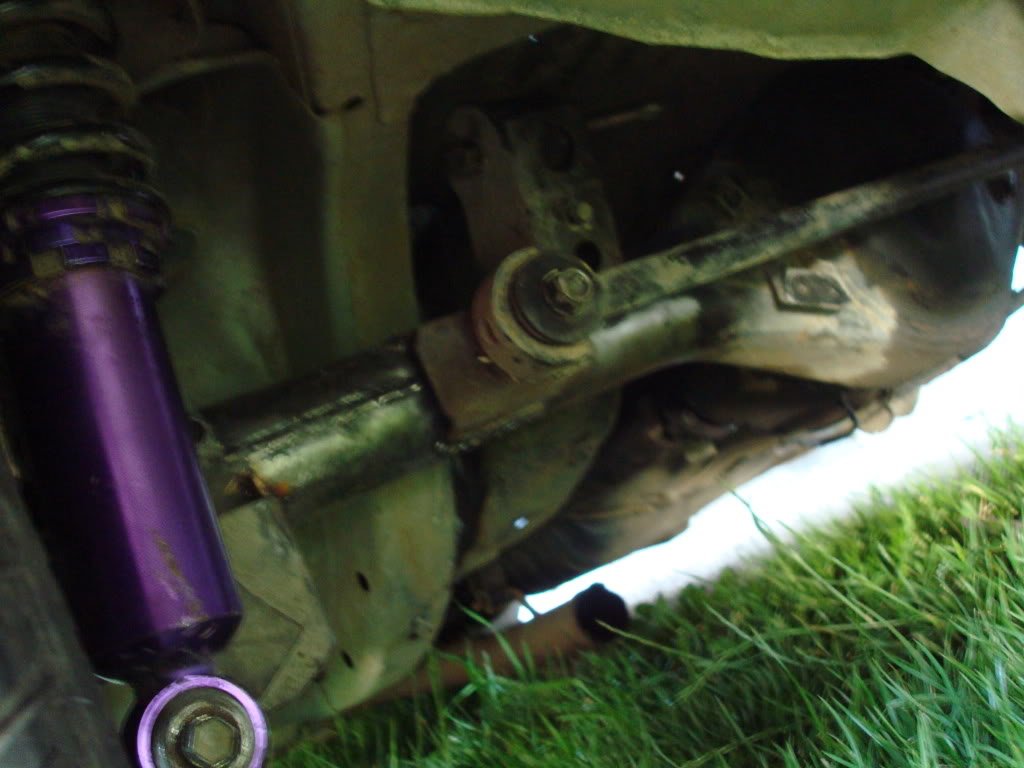

that's wicked, do you have a noticeable difference running the 4 link setup?
More pics of the front please! Looks tuff![]()
cheers guys, it doesnt axel tramp at all now, but in saying that i never drove it on the track without it done. I brought i pretty much how it is at the moment, bar the liteace diff and 4 links. hence i want to make it my own, hence all the new suspension motor and box

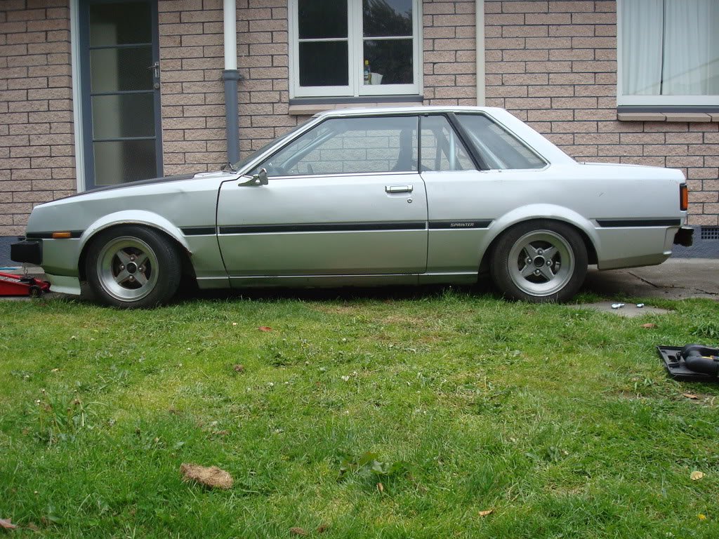

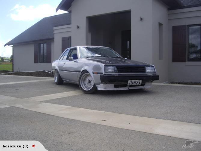

both pics before i owned it
(with home made lip out of ae92 bumper lol)

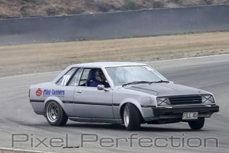

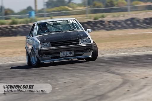

had a drift event on sunday just been, ended up just missing top 16 and battles, i qualified 17th out of 30 lol not too bad for the oldest and least powerful by a mile car
couple of pics

What's the remainder of that front lip from? Looks awsome.
some people just dont read.humph.
