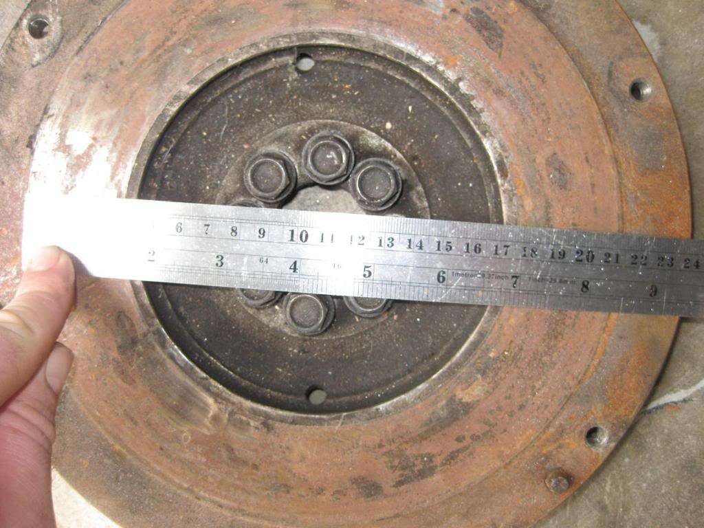

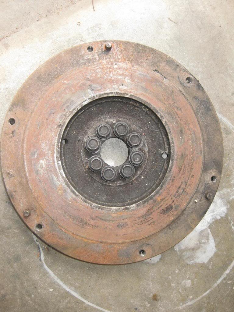

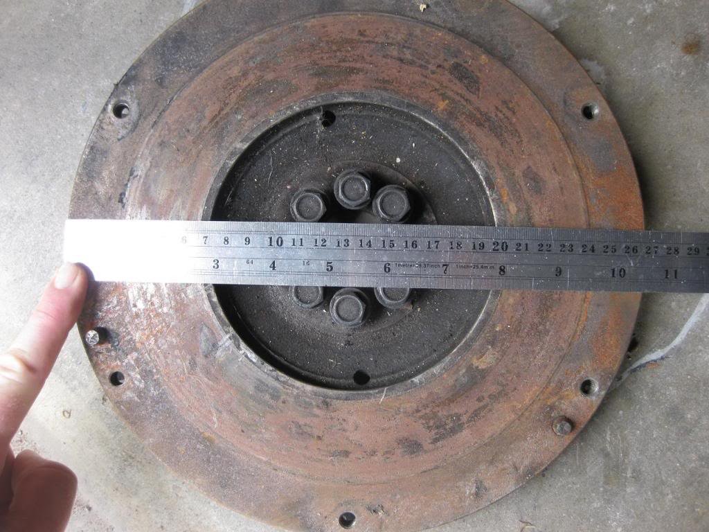

    I need to know what clutch options i have that are available for a 20v rwd application. The motor is stock and it comes with this flywheel which i can only assume is the standard 20v flywheel? (im a bit uneducated when it comes to 20v's)
    now im not after a whoopdy doo clutch, i just need something that will work as i just need to get it on the road and not turn it into a money pit. So i ask what are my options? It will be running a T50, so will a 4ac clutch and pressure plate fit? or even the standard 20v clutch work? are they the same spline as a t50? or will i have to change to a different flywheel to fit a cheaper clutch up?
    any info will be greatly appreciated!

    Any 212mm clutches should fit it: including 7AFE, 20V ST or BT, and AE92 4AGE.
    I know in the past alot of people have said that 200mm clutches (4ac/bigport 4age) fit 212mm flywheels, but mine definitely did not.

    the above comment is correct:
    apparently 5.9 for the BT and 6.9 for the silver, that's a silver in the picture. Many people run an Excedy heavy duty- myself included. It grips well, is affordable and feels like the original clutch.
