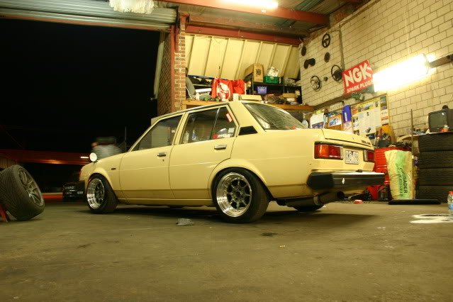

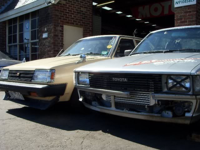

Hey guys just want to show you my little project that i was supose to start about a year ago. been caught up in a little financial problem but now i think im sweet to start this beast!

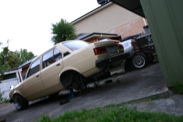

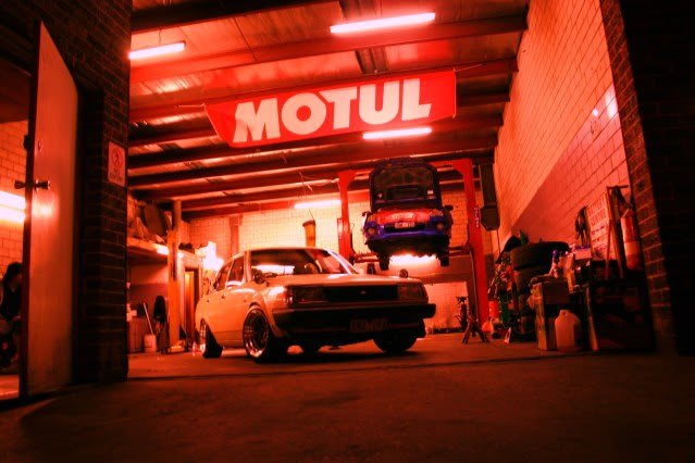

Here it is 1983 toyota corolla 4k with:
Falcon springs
sportmax 002 15x8 -0
ke55 lca
bride bucket seat with bride s13-15 fixed rail (they fit but the RHR mounting point has to be modified,
gk steering wheel
ht skyline 2000 lip ( suited the plastic bumper more ) snaped it tho
A kick ass AC that can give you a brain freeze.
and the best mod on the car is The godfather horn
got silly with the camra.
Basicly i brought Dans car and striped it to the shell

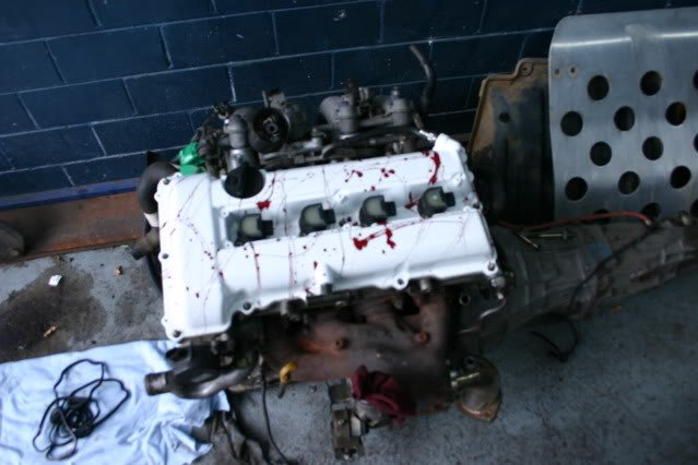

so sr20det - stock (just got rocker stopers)
mounts to suit the AE71 crossmember
exedy button clutch
peddal box
custom tail shaft
r31 diff with twin Vt brakes

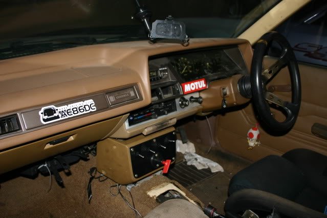

wiring (going to mod it for a few switches and buttons)
carby puck up pump, VL fuel pump and surge (going to be running a 044 xmas prez from my boss)
going for the xt130/hilux/pug suspention and brake upgrade.
cage

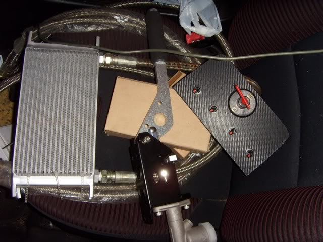

things to get list:
D-Jetro power fc
gt30/71r - < just picked up a disco because its a better choice for responce
nizmo inj - or a top feed setup
few extras

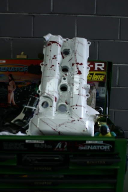

grinded the nissan twincam 16valve logo off and painted it white as freddy krueger finished the rest
engine sitting there waiting to be in the corolla

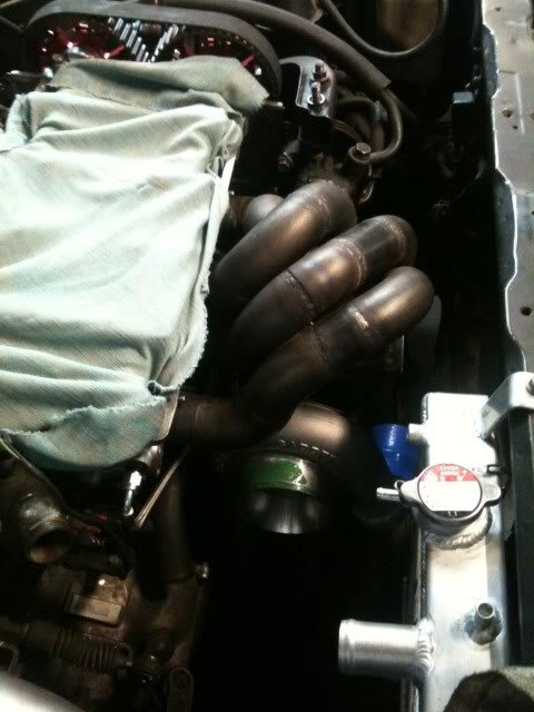

had to put this in! bosses twin scroll manifold work (4g63- to4z) on his galant. mine next! mine next! please.....!
more pics and process comming soon!

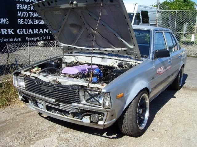

looks really good,is that silver car the 1 from the news lol?
^ not thats not billys car, his has 20v 4agte and is up here in brisbane
~KEEP DRIFTING FUN~
This kind!

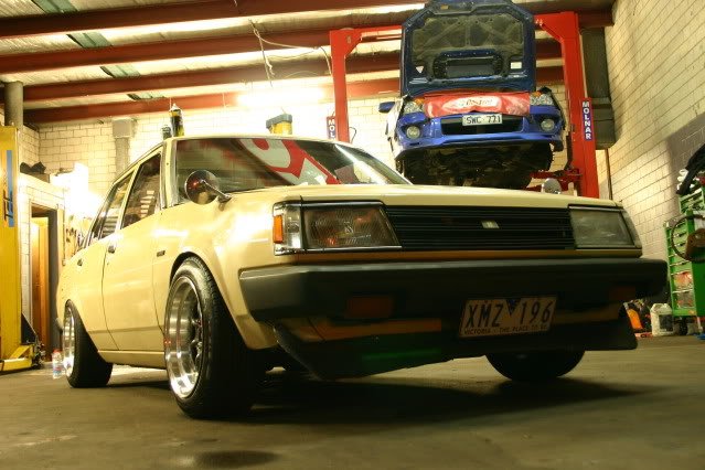

wat tires size u running on the sportmaxxs?
195/50/15 dont run 55's on it or it wont clear the inner guard on lock.
All Beige Everything
Looks awesome! where are you going to mount the oil cooler?
where the number plate is and move the plate to the side![]()

how the switches going to sit.

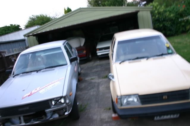

removed the diff on the grey ke and 2more bolts on mine.
work mates ra65 in the backgroundhis going for a turbo setup on the 22r
and his carsgod i love them... im really trying to get him to 1j it as his got a spare motor but his weak lol!
