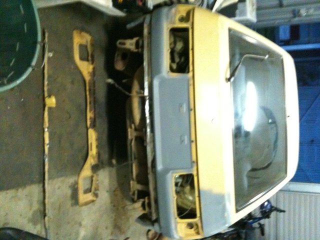

    cut and shut, want a pile of pictures?

    yes i want pics

    the rust in the back of my hachi was pretty bad

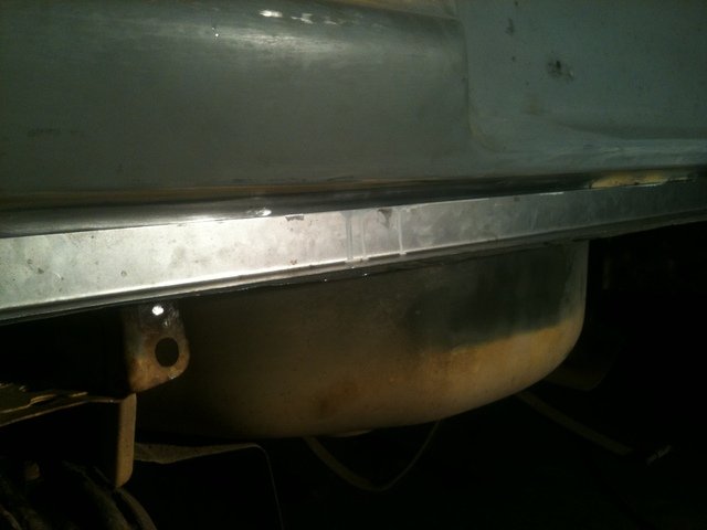

    first i just cut out the beaver panel 30mm above the floor and then removed the lower section completely
    i had this 90deg piece made up at a normal fabrication shop it’s the same thickness as what was removed, because its so thin I was able to easily bend it to suit the radius of the rear then it was just a matter of slowly welding it in without warping anything as for the lower section I was able to buy the panel from Toyota for $350 it just has to be spot welded in and it done ill get some more pic's when it’s done if I’m doing anything wrong or you think I could do something different tell me as I’m teaching myself and I am in no way telling you how shit should be fixed this Is just the way I’m doing it

    Sorry I didn't mean to come across as being rude
    Nice work Sam that’s pretty much what I’ve been doing so far just cutting it out and welding new stuff in
    That’s the top piece all welded in ignore the angle as it's not attached to the floor yet
    And the lower panel I got from Toyota, just needs to be all spot welded together and I’m done
