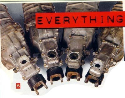

    Something that might need attention too is the shifter... The one that came with the box I had was a crap shape, and as per the seat rails I butchered it trying to make it better. What's the best W58 (or W5x?) gearbox rear to use in an 86?
    Also I hear that an RA60 or something gearbox crossmember could be modded... anything current on that?

    The furthest on the left comes out where a T50 shifter does - so basically, best is from left to right.

    4,116
    all my w5* boxes have had 2nd from left, had to chop tunnell a bit but

    I don't mind chopping the tunnel a tiny little bit, I'm more concerned about how the shifter moves. As an example, I put the shifter in on my box and the end of the shifter was either hitting the dash, or when reversed, was back behind the seats. Any idea what donor vehicles had a sweet W5x box position? That's one question I can't seem to get a straight answer for.
