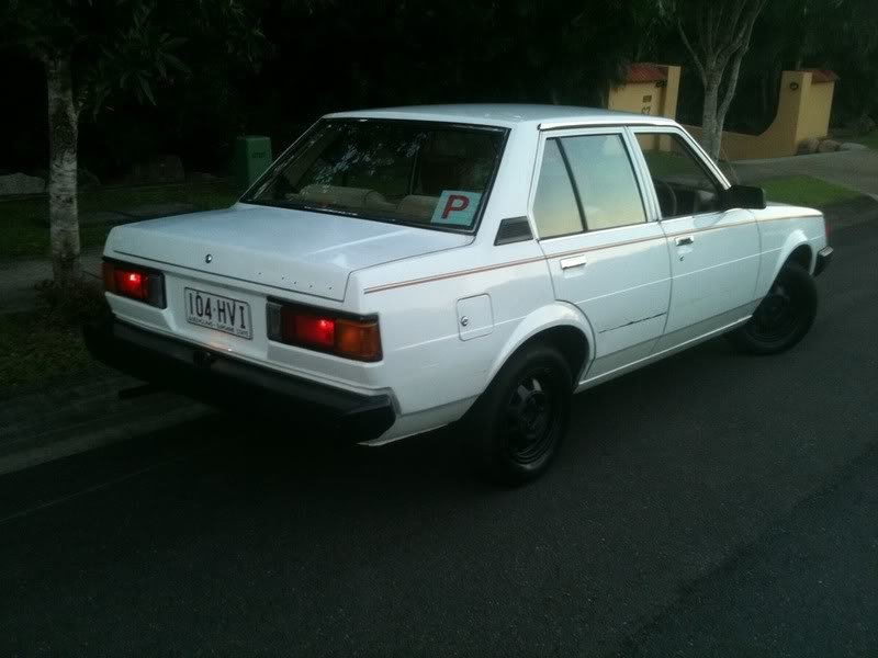

    Hey guys, after along time of searching and fucking around I have finally got my first rolla.
    Specs
    1984 ae71
    CS model
    4ac (original 150xxx on the clock)
    Auto....
    Old man's ride
    Stock as a rock.

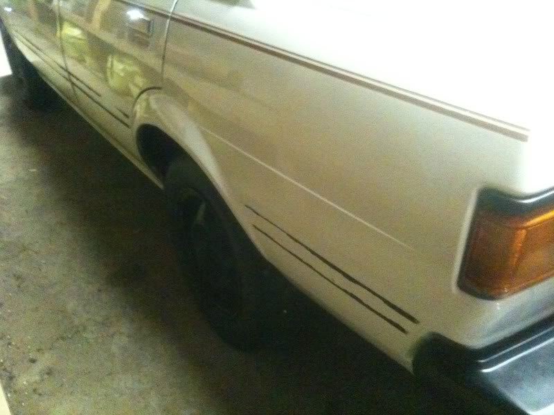

    anyone want to tell me the best way to get the black shit leftover from taking the trim off the side?
    drivers side pretty much all came off at once but passengers side has heaps of it. cheers!

    Heat Gun and patience.

    I used citrus goo remover to soften up the black shit. Kept it well soaked for about 10 minutes and was able to peel large bits off.

    caramel wheel works well ive heard..

    Works for me too and cheapest option.
    If the paint is original it shouldn't peel.

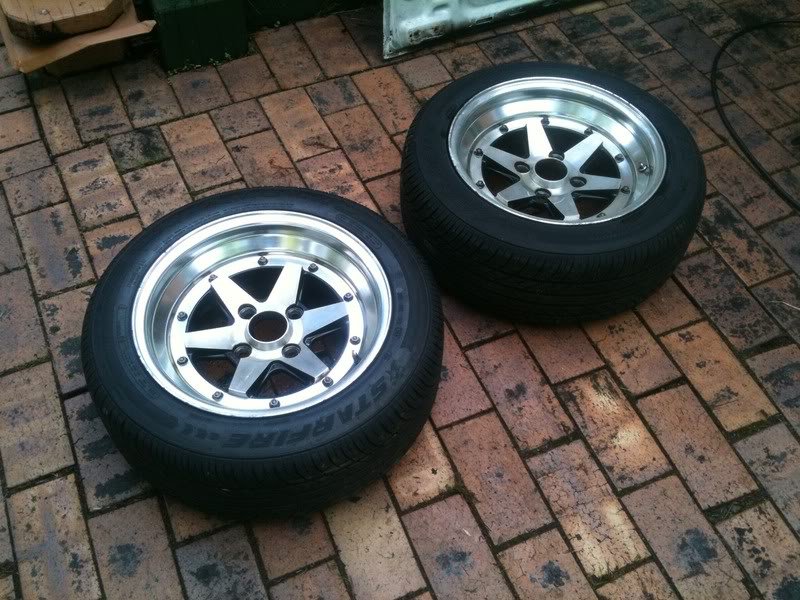

    I have put on new steering wheel, ajps handbrake button, new rack ends, gave the 4ac some fresh fluids all round and had many the fun in her.
    Today I picked up panels, and bonnet for flat front conversion, fender mirrors (at no cost ), ae71 manual pedal box and purchased a pair of 15x7.5 +5offset Longchamps with tires for a price way too cheap to turn down!!!

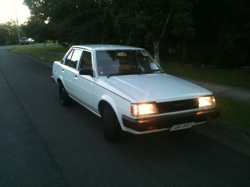

    after some love from the high pressure hose
