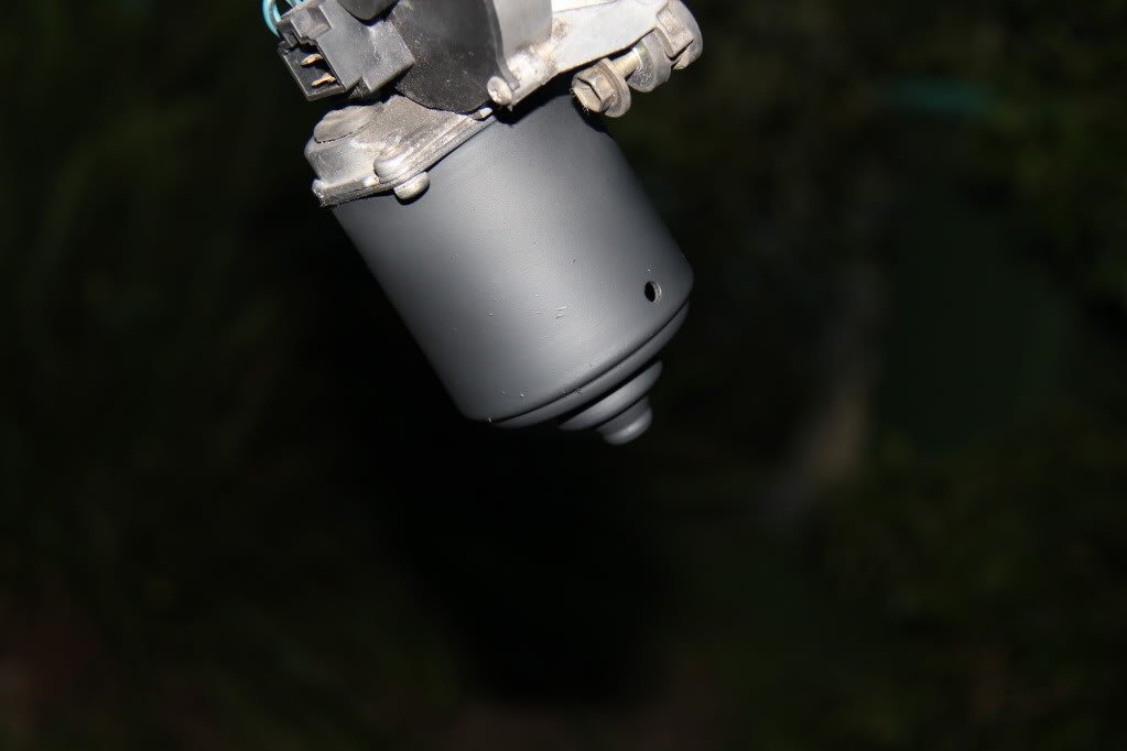

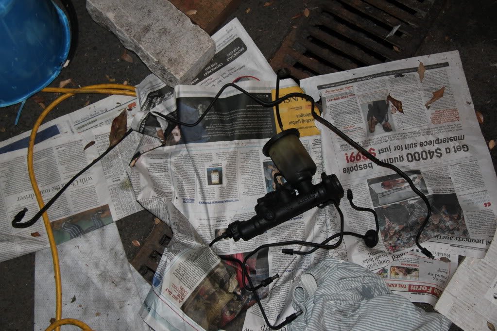

    ok so got some work done on the car today. put the pedal box and steering shaft in, and attatched the brake booster and clutch mastercylinder. spent most of my time screwing around trying to make the master cylinder fit properly....
    also painted all the hard lines in the bay matte black.
    also clean and painted the wiper motor as well.
    oh and a quick question for you guys, does anyone know the size and pitch of the nut that goes onto this stud below the clutch master cylinder.
    and the size of the bolt that goes through the clutch pedal to attach it to that master cylinder.

    it isnt a bolt for the cltuch pedal its a pin, and its a 12 or 14 metric fine bolt, common as, you probs will have 20000 of them in your bolts box from stripping everything
    ryan
    600
    yea i know its supposed to be a pin but i don't have the pin thats supposed to go in there, so am going to use a bolt instead. ok cheers man ill have a look
