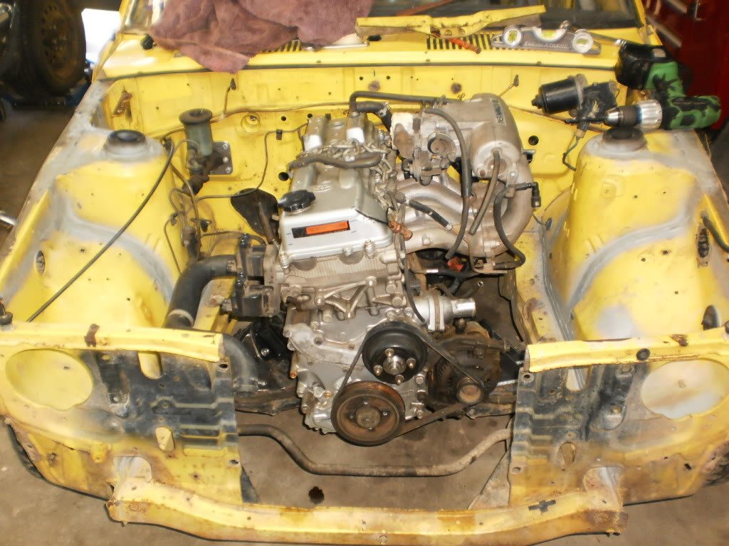

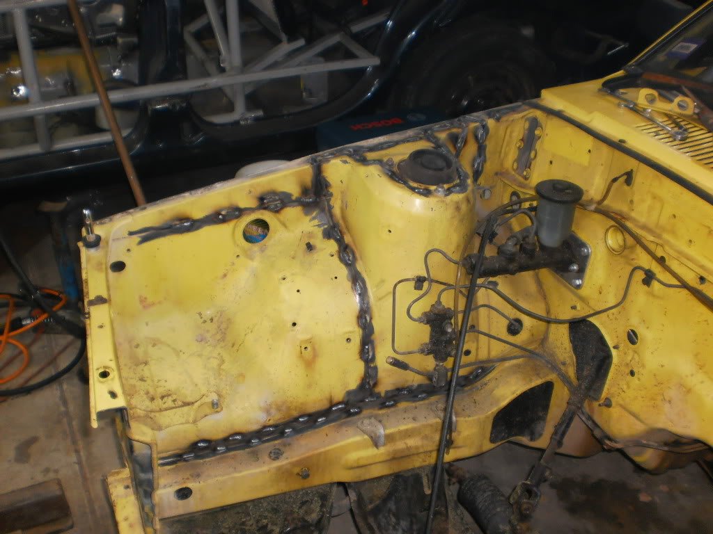

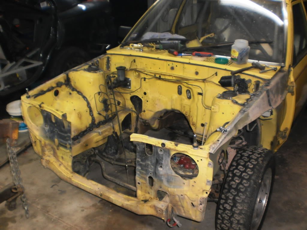

    Took the front end off, got the engine out and started seam welding the car did most of the engine bay and inside:

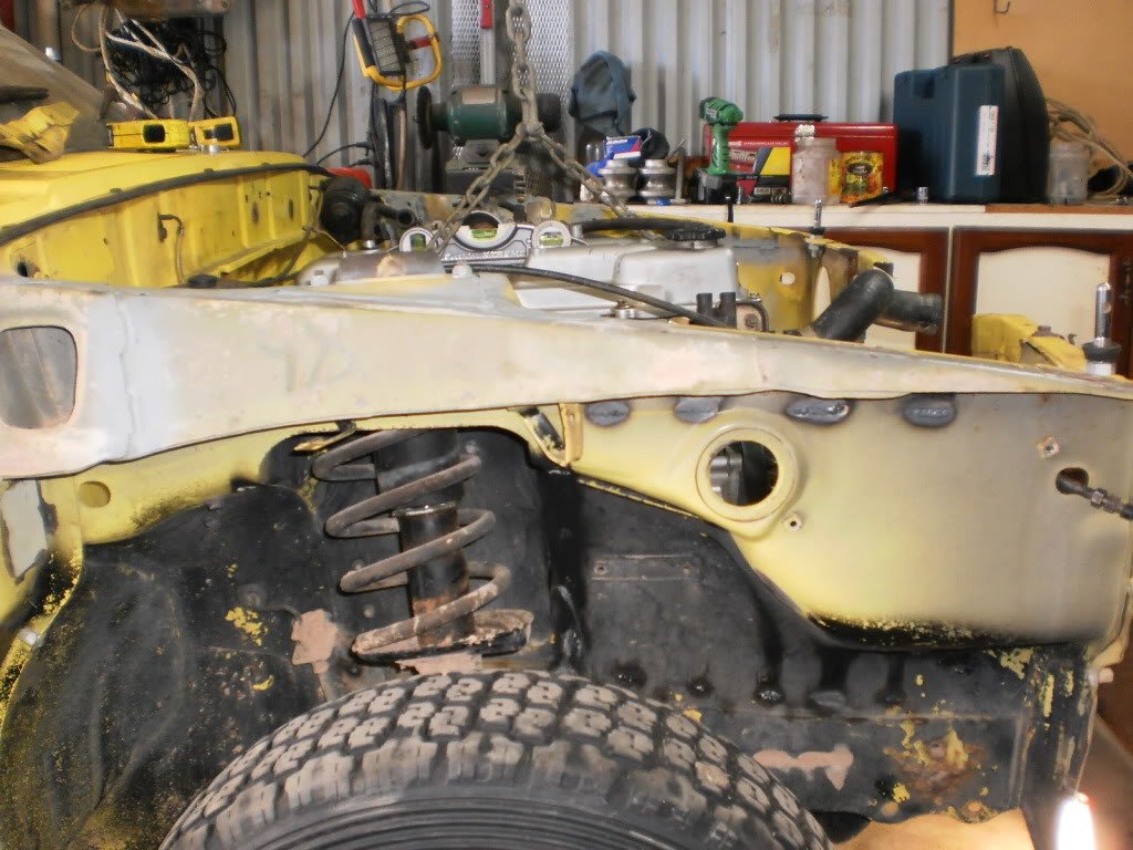

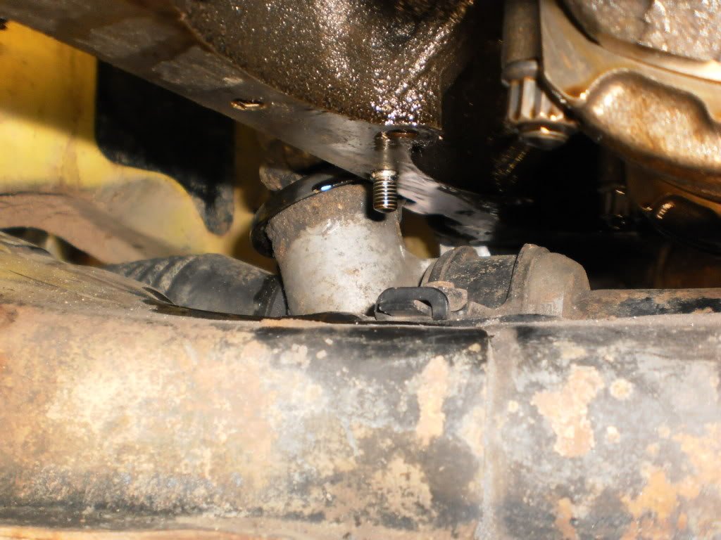

    Time for some pics, thanks to the queen i worked the whole day on the car. My hilux engine mounts arrived and i dummied up some mounts with the engine sitting vertical (im now going to put it in with a lean like standard) I cut the tunnel out, if anyone else does this conversion it is possible without doing this just some slight massaging with a hammer will do and some crossmember spacing. The only way for the motor to miss the bonnet was too low to put a sump on it Im talking like 10mm from the crank to the crossmember. I cant space the crossmember lower as i still need ground clearence as im racing off road atm. So I need to raise the engine and a gay bonnet bulge will be in order:

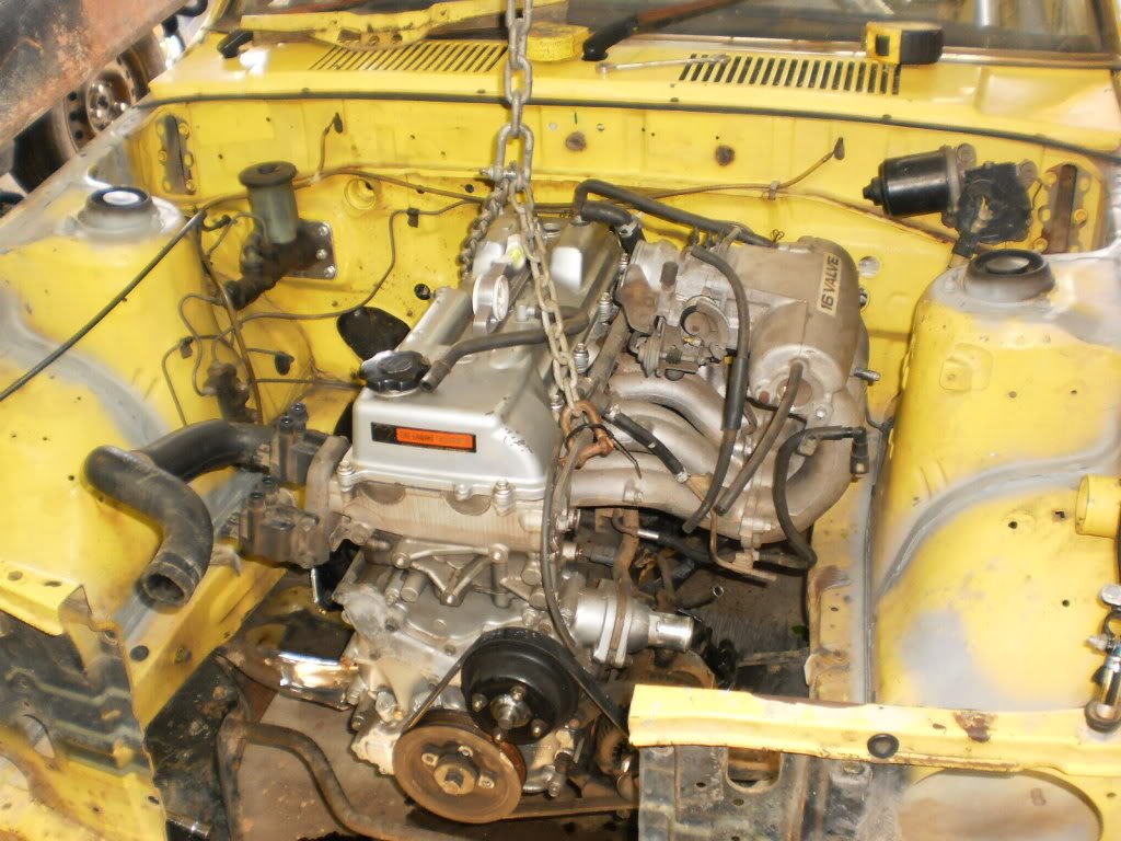

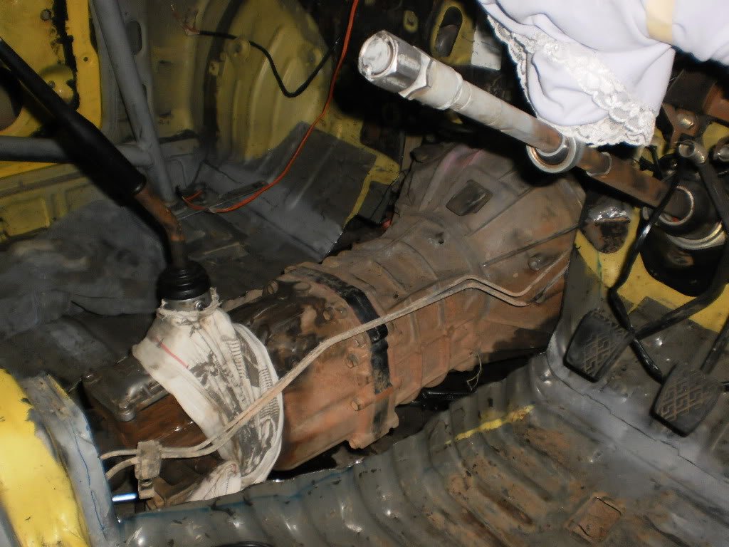

    Finally got the motor and box in yesterday:

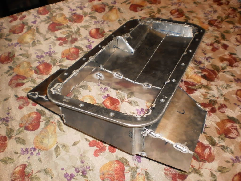

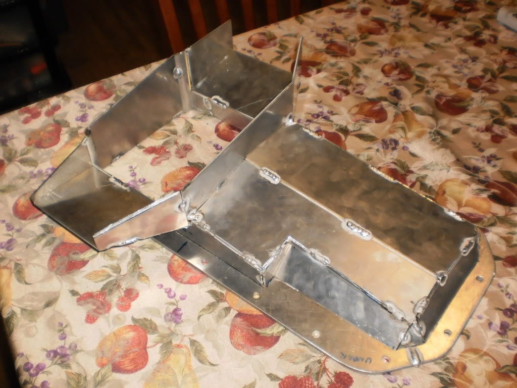

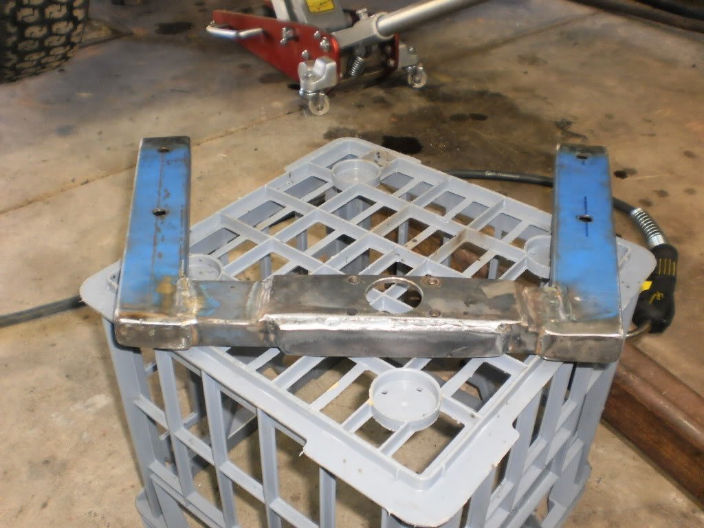

    Sumps almost done:

    really good man! sump looks the goods!
