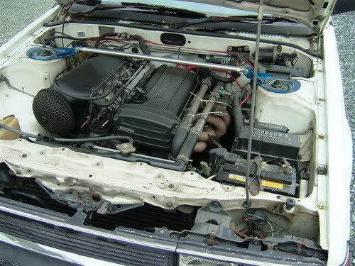

    here you go henry:
    20v that thing or not . Hopefully once your car is sorted out, another cruise on the agenda? gl with everything looks gd.

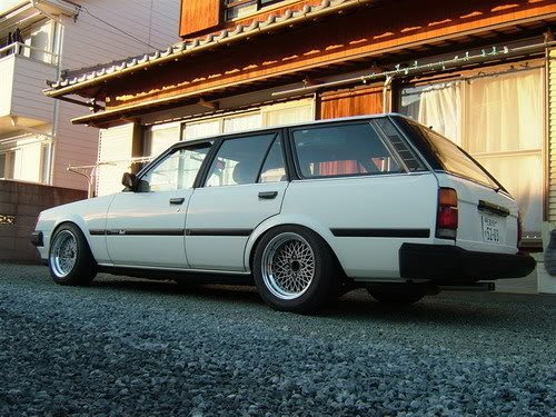

    20 Valve Carina Surf

    Clutch was changed today. Probably the easiest clutch i've done. 6 main gearbox bolts, 4 gearbox stay bolts, starter motor off, unplug reverse switch, disconnect speedo cable, 4 gearbox crossmember bolts and BAM, gearbox out. 39 kilos of W55 on the ground.
    We found this:
    Clutch disc worn down almost to the bolts, and hotspots evident in the flywheel and pressure plate, as you can clearly see even with my horrible telephotography.
    Flywheel was removed, hotspots removed, rear main seal replaced.
    Everything was refitted without any drama. Konakid painted the tailshaft 'because he could'. Gearbox extension housing seal was replaced. Funnily enough neither of the aforementioned seals were leaking.
    However the camshaft cover gasket was. Well, i wouldn't actually call it a leak. More projectile vomiting oil into every fathomable corner of the engine bay. Seriously, the front of the motor is COVERED with it. So off came the cam cover. While it was off, i decided to paint it 'because i could'. It is painted in a super rare factory colour known as 'funky black'. Few have seen it and lived to tell the tale. Seriously.
    End result was something like this -
    It looks quite out of place because it is CLEAN. Should look good when the rest of the engine bay gets a once over with the high pressure gun.

    Yeah yeah.
    Carina surf is tight!

    sick!

    fuck now ive fallen in love

    wait till its painted with flared guards, 15x9's etc
