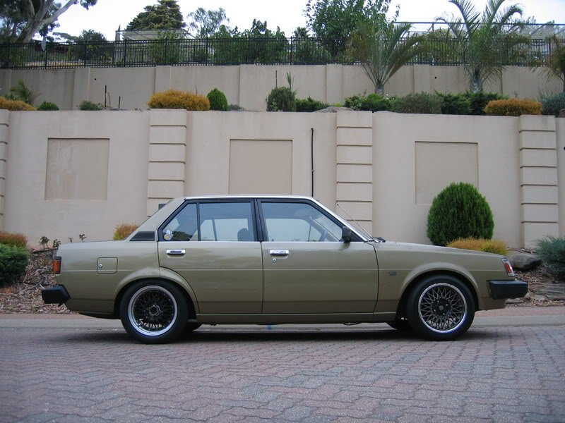

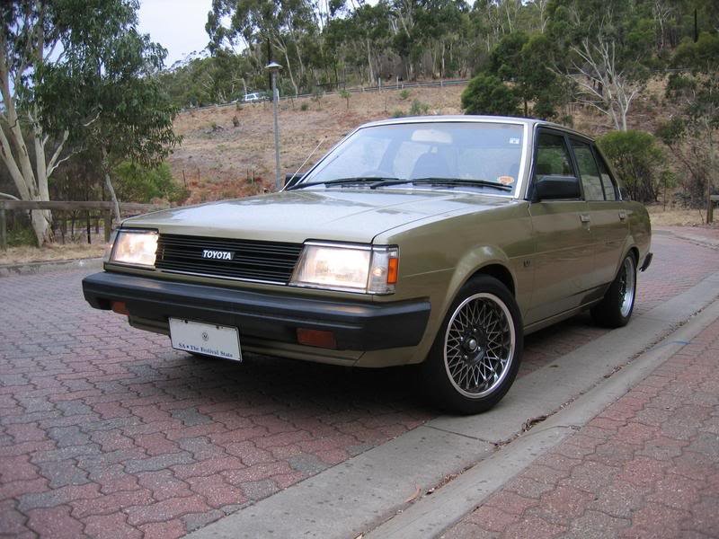

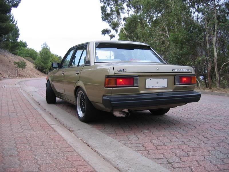

    15 x 7 SSR,s all round

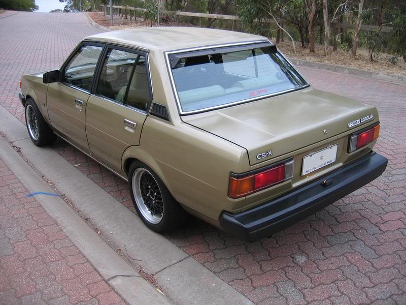

    I had to hammer the rear right guard to fit the wheel as it had a dodgy repair job which made the guard sit further in than standard. The result from doing the hammer job was two big chunks of bog breaking off. The solution, glue the pieces back onto the guard and paint with touch up paint.
    A granny shade can be made into a rear wing with a bit of cut and paste.
    All stickered up.

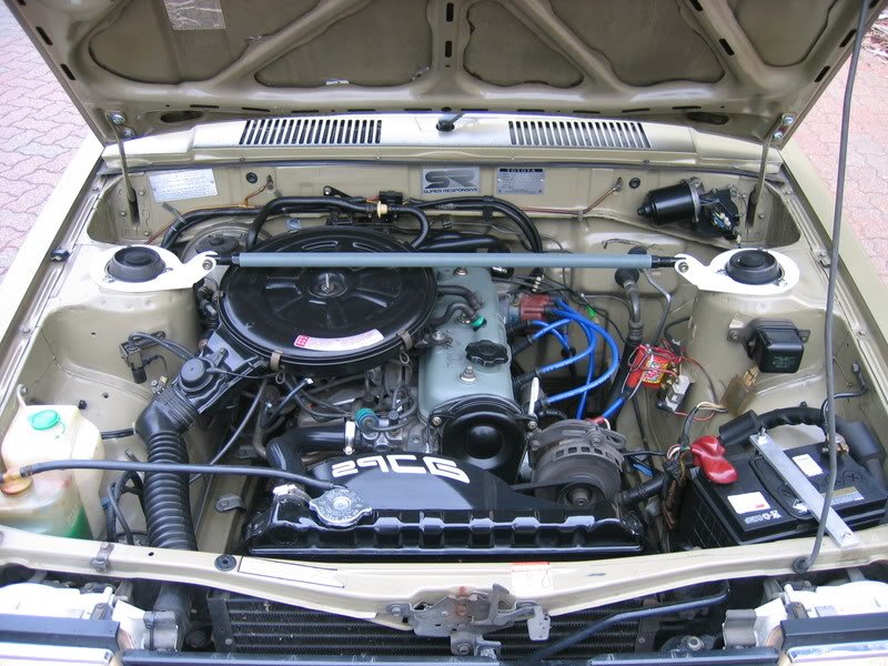

    Stock 4ac (rebuilt motor by previous owner)

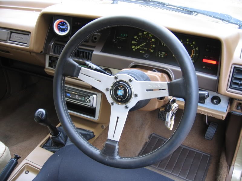

    Nardi, Tacho, Fire Extinguisher and Radio. All the essentials for drifting.

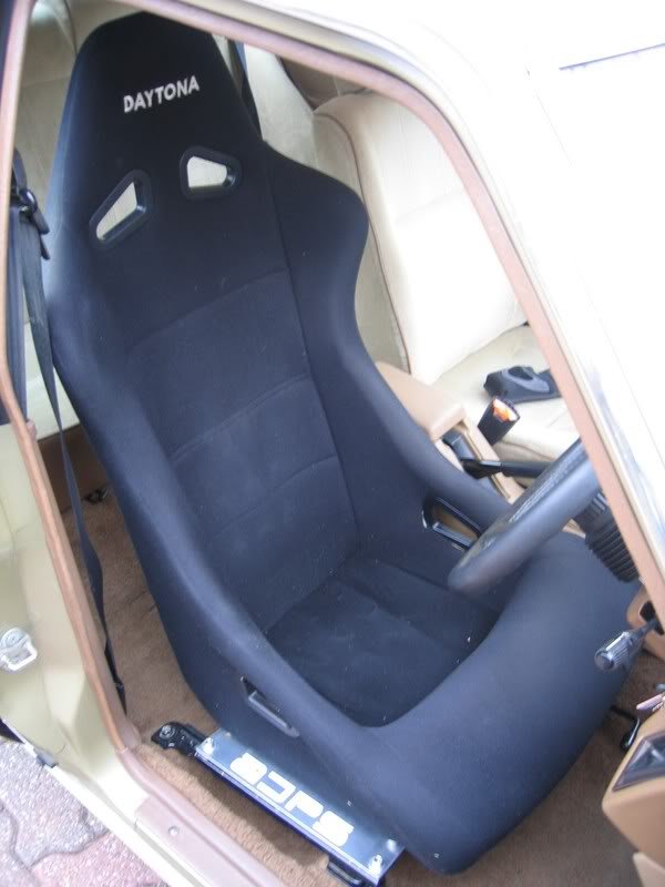

    No need for rear seats if its only you driving the car!! It is also a good excuse to never be the designated driver or give you mates a lift.

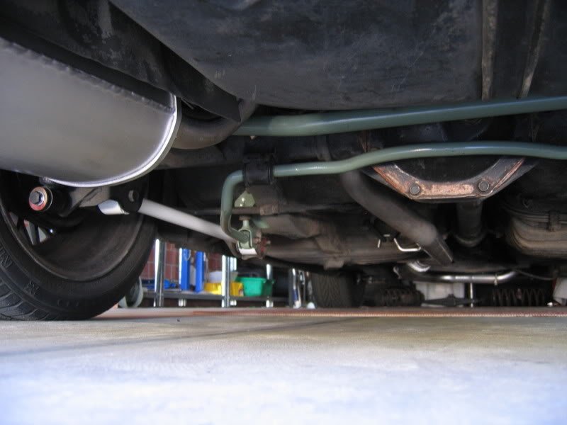

    Rear suspension = AJPS 6kg springs, KYB short stroke shocks, Whiteline Panhart Rod, Tercel Rear swaybar.

    Engine:
    Trusty 4ac,
    32/36 DGV Webber,
    Whiteline Adapter plate
    Port matched intake
    Modified and welded exhaust manifold
    Full length 2 inch custom exhaust (By Streamline Exhausts)
    New Waterpump
    New Clutch Mater
    New Clutch Slave
    New Brake Master
    New Battery
    Reconditioned Radiator
    All new coolant hoses

    Rear Suspension:
    AJPS 6kg 210mm free height springs
    KYB Exel G's (Short Stroke)
    Tercel Rear Sway-Bar
    Super Pro Upper and Lower Trailing Arm Busings
    Rear Strut Brace
    Whiteline adjustable Panhard Rod

    Interior:
    Daytona Black Bucket Seat
    Dildo Shift Knob (150mm)

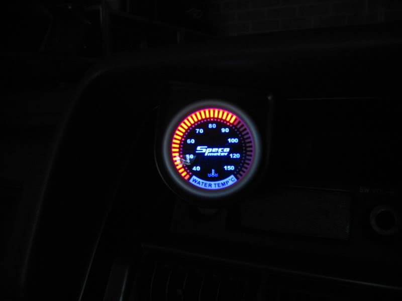

    Speco Water Temperature Gauge
    AJPS drift button
    Wheels and tyres:
    SSR Fins 15x7 Front and Rear (unknown offset - near 0). Reconditioned, Polished, Powder Coated White.
    Front Tyres: Toyo R1R's 195/50 - R15
    Rear Tyres: Unknown Junkers 195/50 - R15
