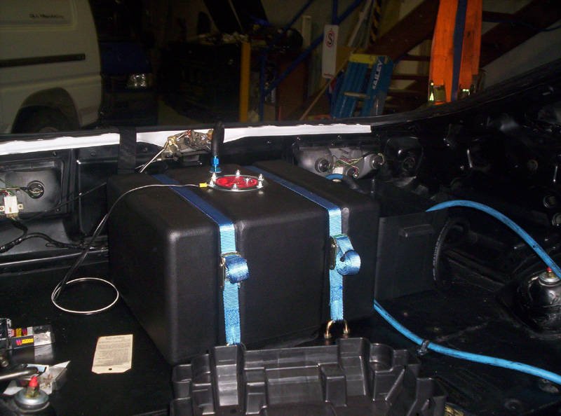

im tinkering with the idea of a fuel cell, reasons being i can cut out were spare wheel goes and centralise the tank, saving wieght and better balence, and hopefully not having to put in a surge tank and two pumps.

ive ended up putting a 48litre fuel cell in with a surge tank and a commodore fuel pump, we cut the rear floor out were the spare tyre well is allong the chassis rails and welded a flat piece of sheet metal in, this means the weight at the back will be as centred as possible and fuel supply and starvation will never be a problem, this was to my suprise a easy and cost effective solution
