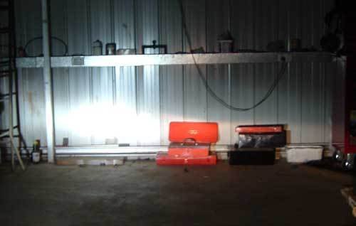

    I love my HID's
    this pic is with one side upgraded, spot the difference
    however the glare is nasty and if I could go back in time I would of bought the warmer 5000K globes instead of these 6500K globes
