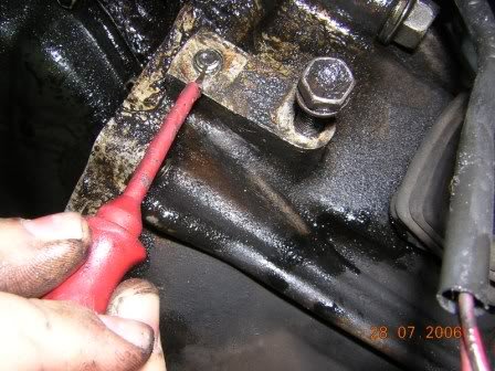

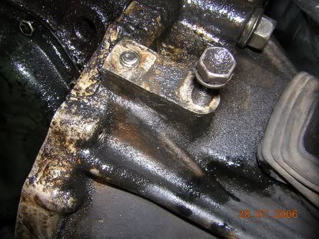

This is fairly obvious but just thought id throw it up here.
When mounting up my slave cylinder after the gearbox swap i decided to take some frustration out on the bolts, bad idea.
Luckly the break wasn't clean so the bolt had sheared off from the head and remained in the block.
Solution:
Whip out some wd40 or any spray lube and grease the puppy up good.
Then use a small screwdriver or centrepunch and mallet to hit the shards in an anti-clock wise direction. At first ur gonna have to belt the shit out of it, as itll be tighter than a nuns... But once its moving light taps will safice.
Once you have made a few revolutions their should be enough exposed thread to use ur favourite pair of multi-grips to finish to job.

what a pain, least you got it out without too much trouble
And if u cant get the prick out. Give Steve Rickets a call if ur on the coast. he can get anything out of a hole. and he dont muck around![]()
drill it out...
if you cant get it out...
4AGE 16V
This is alot cleaner then drilling it out.
But a pain in the arse. Good work.
