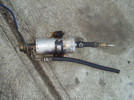

    i have just recently poped and engine 4agze in my aus sprinter!
    im doin my fuel system now, i need some help to install the new fuel
    pump.. im not exactly sure what it is.. i think its a vl turbo one...
    any help on how to modify and install the pump would be appriciated...
    here are some piks..
    stock 4ac fuel thing
    unknown fuel pump

    is that external pump? you may want to get a surge tank

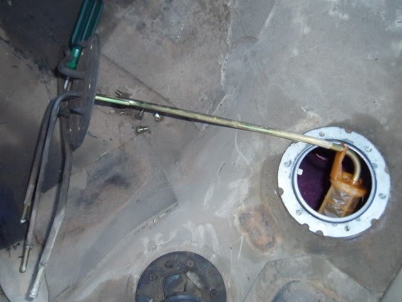

    so is the fuel pump an external one?
    i was told to get to my existing fuel pump i had to drop the tank
    so thats what i did.. now that i have access to it.. i need to know how
    to put the fuel pump in...
    im kinda noob so a detailed steps on what to do will help
    after i buy the lines then what do i do?

    dont worry about all that shit, ill exlain it the noob way
    see that long pipe that goes into the tank and has the filter thing on it? hook this up to the inlet of the fuel pump then hook up the outlet of the fuel pump to the fuel feed line (with high pressure fuel hose and proper EFI hose clamps of course)
    keep the return line as stock, but if you mess up the lines, the return line is the one that goes into the tank, as opposed to the one that ends at the plate.
    on the street you wont notice surge until you get down to a quatrter of a tank, you can drive when the empty light is on but it is a pain in the ass.
    *hint* if you just install a swimmer high pressure pump, it will surge worse than if you follow my above instructions,
    if you plan on drifting or racing on a quarter tank of fuel, install a surge tank.

    yeah my mistake, it is an internal type, may I sujest you save yourself some hastle and use an external type?
