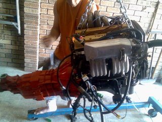

  3. #43
    AE71 Rolla
    Putting it together
    (that's not me by the way :lol: )
  4. #44
    AE71 Rolla
    What efforts it was doing it on a fucking hill. It was too hard to move it anywhere else coz it's got no brakes at all. It only took us an 1 and a bit to get it in.

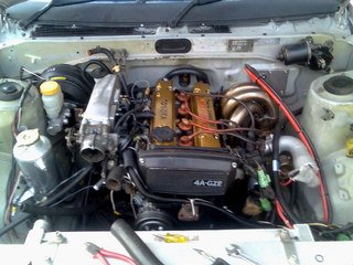

  7. #47
    AE71 Rolla
    It's in along with the tailshaft. woo hoo.
  8. #48
    AE71 Rolla
    Not too much room for thermo's and afm so it's gonna be a tight fit

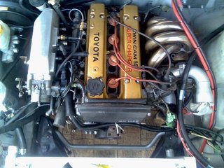

  9. #49
    Phirom
    881
    Man, I love them fucking cam covers!!!
    Looks good, thermo should be no probs to fit, plenty of room
  10. #50
    971
    Just abit of heads up, I have the same turbo manifold on my setup, the dizzy, protect it ! it will melt etc etc. I talked to josh young and he also told me that his car use to melt dizzys! not jus the cap but hte internals. If you have an aftermarket ecu I recommend in the future getting multiple spark or waste spark setup with a gze cas distributor. For hte meantime make a heat shield or put some wrap around the manifold and/or distributor.
