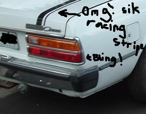

Ok, some pics for you. firstly, the standard ones.
And the T-18 lights. they look alot bigger like i said earlier.
And after doing some further research, i.e. attempting to fit some, i have discovered the XT130 tailights will take some modification to fit. just a quick stint with the drill, and a bit of time with the pliers (the hole where the light assembly goes in is just a smidgin too small) will see them fit. and as im a lazy mo-fo, i couldn't be bothered, so here's the chromey tail lights im talking about.
The corona is my car, btw.
Do with this what you will.
Javal.

I could be wrong, but I think the only bling you will get will be the chrome between the top and bottom lenses, and the chrome end bits, as the chrome surround is a seperate part fixed to the rear bodywork
Nope, the chrome surround is part of the light assembly, i took them off. the strip across the boot however, is another matter.
