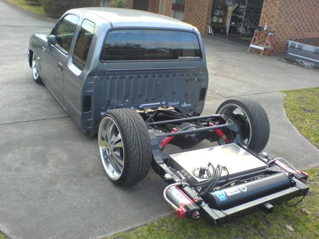

    heres my ute that i just finished building

    Fark man, you're a machine. Loved the 180 but that Hilux is something else!

    Thanks mate, it took about 10 months to build (basically built the chassis by hand) all just to make it bounce. Its the tow vehicle/everyday car.

    Looks like you gots madd skillz... ute looks crazy as well.
