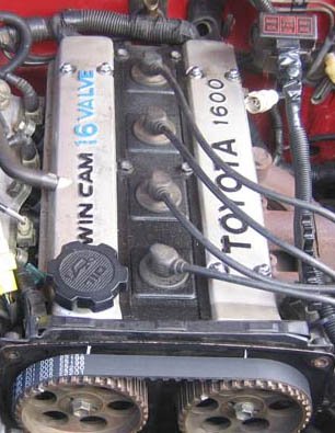

    3. paint the rocker cover on the 4age as its slapped out and yuk. GOt a complete rocker cover and spark plug alley cover from a mate, so will just clean that one up (mates sandblaster) and give it a coat of paint. Tossing up what colour to go with on the cam covers though (spark plug alley colour will remain black)........
    Option A - standard look
    Option B - shiny silver & black writing (with 16 valve in blue to keep with JDM)
    Option C - nice metallic blue colour
    Option D - red "wrinkle" paint
    So they're my thoughts about where to go next with this little car.........feel free to chuck up your thoughts/opinions/experiences!
