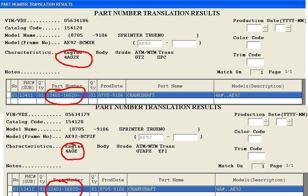

4age and 4agze cranks are identical from the corresponding year of manufacture. The obvious different ones would be the early 40mm type bigports but the later generations share the same internals EXCEPT the pistons. This is confirmed through the Toyota EPC with both GZE and GE crank variants sharing the same part numbers.
Eddie.
