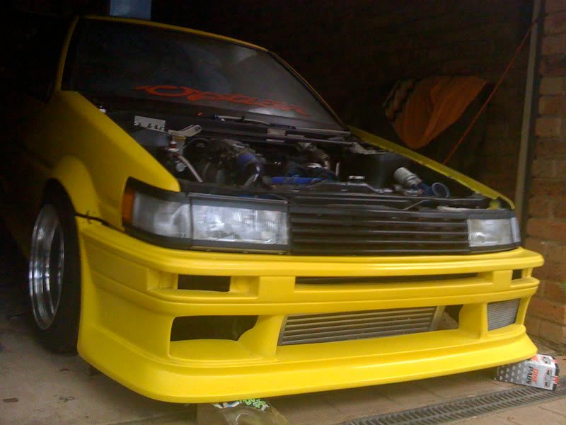

    My mate used to work at a paint shop and we spent about 4 hours and 4 litres of paint mixing a custom color.
    it's mainly yellow pearl so it's bright as hell.
    971
    I like the engine bay. Very neat and accessable.
