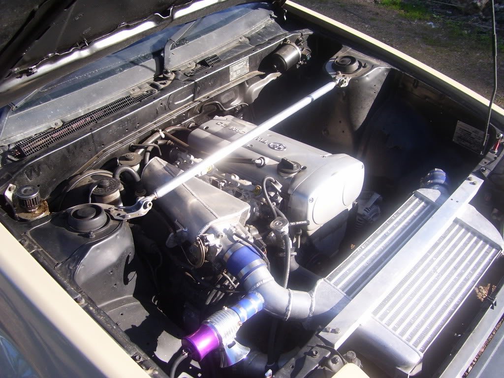

OK, got some more pics, mostly of the engine to show the intake setup, and also the cooling system. I haven't done too much more, just put the new TRD springs in it, polished back the wheels, and had a new exhaust made up.
Can't really see it, but the piggy back gizzmo fuel controler is mounted in the clock space
Custom intake manifold with 3S-GTE throtal body and 7M-GE injectors
You can sort of see the custom mounts for the supercharger here, and the inlet/outlet of it
Custom (butchered) alternater bracket
You can see the normal water outlet to the radiator blocked up on the head, also the cam angle sensor, and the coil leads coming from the cabin
You can see the pipe that normaly goes from the head to the water pump has been modified. It's now the out let, and the inlet from the radiator goes to the external thermostat then to the water pump

Engine:
Super Charged 4AGE 20V Silvertop
SC12
4agze MAP / DLI- multicoil ECU with a Gizzmo piggy back
V-Mount Intercooler
Twin core custom radiator with electric fan
Custom alloy Inlet manifold and intercooler piping
Oil Catch can
Ignition coil's mount inside car
De-loomed, Engine loom minimised, engine bay wiring hiden, anything forward of drivers seat not required removed.
4-1 Exhaust manifold lagged
2 1/4 inch exhaust

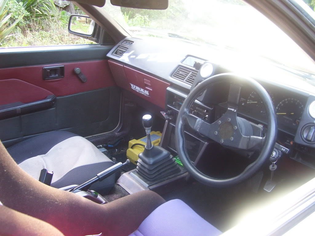

Interior:
Tomei Steering wheel
Buddy club gear knob
Cusco fixed back drivers seat
RJS 3 inch 5 point cam lock harness
