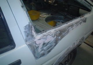

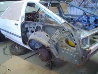

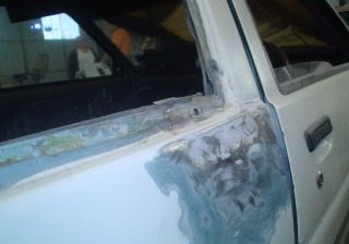

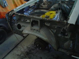

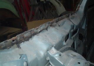

    Got some pictures of some the spots that need to be fixed. not very good quality but they were sent via e-mail. Unfortunately no pictures of the front guards as he forgot to take them :unsure: Where where you can see the bog, that was all over the sanded back part, but those quarters will be getting cut out and replaced with the new ones as you can see. And the whole back under section near the spare tyre well was all rusted out which he has fixed.
