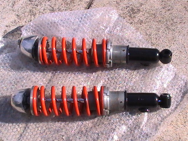

    At the start of the build I wanted to get this on the road as cheaply and quickly as possible.
    Then some items appeared on the forum....
    .... then they appeared at my place.
    TRD adjustable shock based rear coilovers. A rare rear setup i couldn't pass on.
    They currently have 7kg springs, but I'm thinking they will be too vicious for the road.
    Anyone have a suggestion for comprise of street and track grip spring rate??
    4.5 rear? With 6kg Front?
    And a FC front brake upgrade kit. Too cheap to miss out on.
    So now this build is snowballing.
    Anyway, on to fitting the rear coilovers.
    Because these are a much shorter stroke than standard, the bump stop needs to be shortened to allow for travel. So off with 2 bumps...
    While i was under the back, i also installed a TRD sway bar, Noltec PanHard rod and 3 braided brake lines.

  3. #43
    971
    yer, try get some 4.5kg springs for the rear Dom and 6 for the front. Should make it a nice daily guy I think im going to down grade to these rates in the future on mine.

  6. #46
    todd
    currently rolling on 7kg coilover front and 4.5kg rear and its very bearable for my daily dom.
    4.5 and 6 would be ideal for daily i think.
    cars coming along well. so keen to see how much an imporvement the sc14 makes

  10. #50
    todd
    im not sure, it might be an idea just to up it to 7kg and 5kg, the rear end of mine at 4.5 seems a little boaty/rolly sometimes, but its still not soft by any means. mine is exactly that, a dedicated daily. and dont really have plans to take it to the track just yet as alot needs to be upgraded etc, but if u intend of frequenting the track a bit more, u might even want to look into getting two pairs, like a 4kg for streeto and 5 for track.
    but yeah, 4.5 does the job for me. might just have to chop and change til u find what suits i suppose lol.
