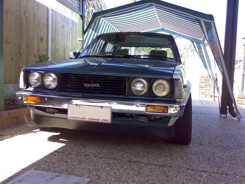

    thanks for the kind words guys, and yes that picture is particularly crap, i can never seem to get a pic of the car that makes it look any good :lol:
    at the moment its got no rear bumper on the back at all, so kinda hoping i don't get done for that, no number plate light etc
    hoping to get the shiny rear bumper on this week :2thumbs:
    i really gota start painting it to.....
    heres a better pic i took today

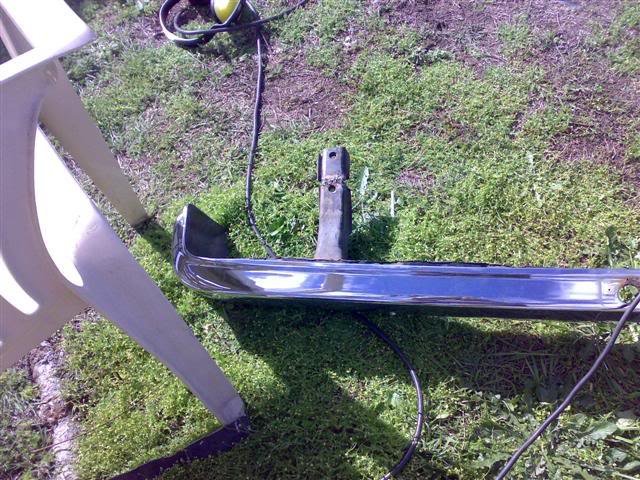

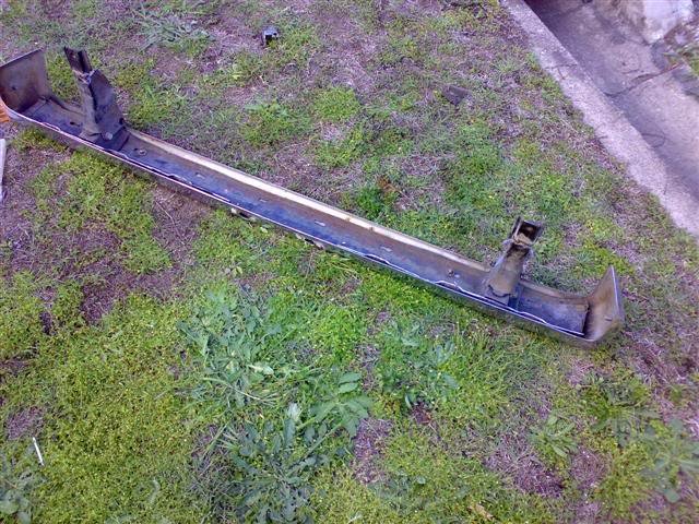

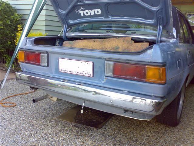

    ok well big thanks to greg for his help again today (bahnuggettt)
    lest just say the rear bumper was a MISSION!!!
    heres a couple of pics of what we had to make up to get it to fit on
    this is using the stock bumper and modifying the crap out of it
    ok heres some pretty pics of the mess we made...
    comment away!
    edit: that toyo sticker is worth like 5kw, and believe me...its worth it

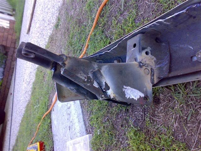

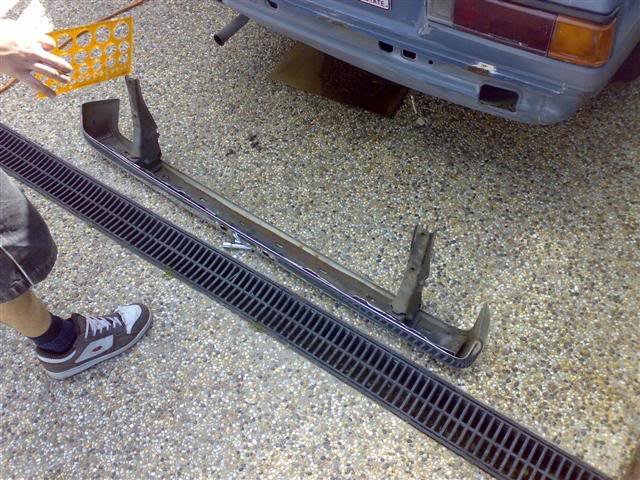

    woo!! mission indeed.
    to explain, we used the standard metal mount the plastic bumper used.. hacked the crap out of it with an angle grinder.. bolted the chrome bar over the top.
    then... shortened, and moved the parts that bolt onto the actual car as you can see.
    its MY awful welding job so dont blame dave for that heheh
    here's a pic to show how we shortened the mounts.. cut about 55mm out of them, then welded them back together. this was before we moved them.
