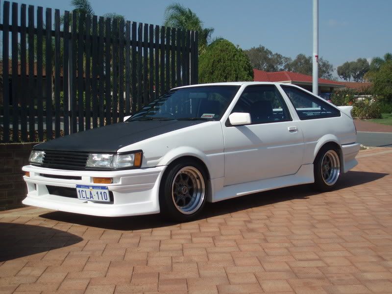

    Black Marker
    Drill
    Cables Ties or Tec Screws
    Sander or File
    Grinder to cut front bumper support bars for the front air ducts on Vertex front bar.
    A friend to help hold the other side when marking kit and fitting kit
    Use the Sander or File to take small amounts of the Side Skirts corners to make them fit. Keep putting them on and checking them each time to see how much you need to keep filing off. A marker and a friend will make this job easier.
    Put my front bar and 1x Side Skirt on about 2 weeks ago in around 1 and a Half Hours so it doesn't take too long
    Finished product:

    yup jdm brakets and cable ties are the shit.. though mine was damaged i still made it fit nicely.. it actually sits better than the oem bumper
    as mentioned above sideskirts jus need to be shaved in the corners.. and i didnt bother with rear bumper as my exhaust was too big
