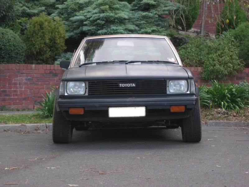

Hi everyone, I fitted Xt130 arms into my ke70.
Atm my setup is :
complete ae86 struts,disc,calipers
ke70 springs
Kyb inserts
86/ke70 tie rods
Xt130 arms with new poly bushes.
Since installing them, my car has gained a fair amount of track and noticible camber
I have yet to get a professional wheel allignment, (which may be the problem totally)
I have found that mid corner on a fast entry the car oversteers big time! I have taken two quick corners top of 2nd gear in the dry and just spun the car out. With the original t18/ae86 lower arm's i was running before it would have stuck those corner's easily.
Since the front track has increased so much should i increase the rear track to counter-act it? Or is it just my car!?
Post up your results. What differences did longer LCA's do to your handling?

I've got corona arms and really like them, your camber looks like it has more ... wtf. Just do a trusty tape measure wheel alignment, use matching tread patterns on each wheel. You're gonna have major toe out issues if you haven't corrected the wheel alignment.
Unless you put RA40 strut tubes in a stut bender, the stub axel angle will be out, kills handling and an AE86 -KE70 -AE71
corona's or sigmas?
look like sigmas that camber increase is pretty drastic
I just put Corona arms in a stock sprinter and came out with 1.5deg neg camber. Not nearly as much as that photo shows.
But my first point should be GET A PROPER WHEEL ALIGNMENT. The single best thing you can do to improve the handling of a car after changing any steering/suspension bits.
Also I believe RA40 struts don't screw with camber, only *A6* (and XT130) struts do that.

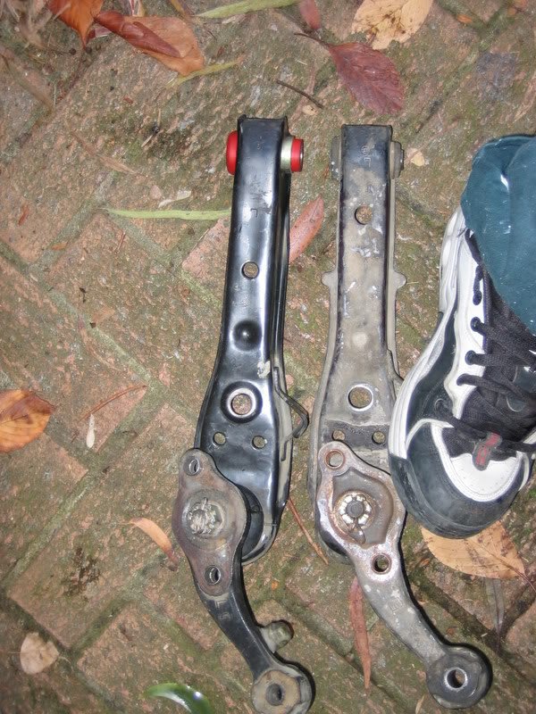

These are the arm's i put in. (new ones are the xt130,old looking ones are t18) I pulled them out of a self serve wreckers and the I.D plate said xt130, so i assume they're right?
