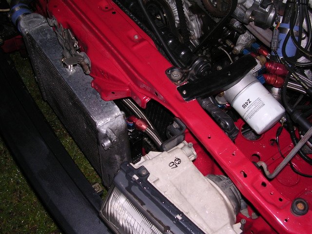

    the one on the block has no specific name it just replaces the oil filter and supplies the relocator with oil and has a return for when the oil comes back (cooled). the relocator has a thermostat fitted, that particular item had a 80*c thermostat.
    that setup worked as follows
    oil to relocator
    through filter
    through cooler
    back through relocator
    back into engine
    cooler oil is used by the engine
    the original 4AGE setup uses the sump return as it cools the oil after its used then drains back to the sump
    both work
    the first one more effectively IMO

    Now I see, what I have is an oil filter relocator kit and someone just plumbed a cooler in the middle of it. Looks like I'm going without a thermostat and I'll just monitor the temperature to see if I have to re-do the system with a thermostat.
    Gilly's set up is HKS.

    ken here is my setup, its got no thermo but runs at 70-80 in winter mind you im still not aloud spritied deriving tho
    28 row chinese bodgy one, takes a bit of working around to make it actually work. is full flow tho

    I need that plate there. Are you sure it doesn't have a thermostat built into the plate?

    Finally found a pic. Same thing as Gilly's.

    no thermostat in mine im fairly sure but me being me i didnt even look hahaha
    by the looks of things it seems mine is twice as big as others on here :o
