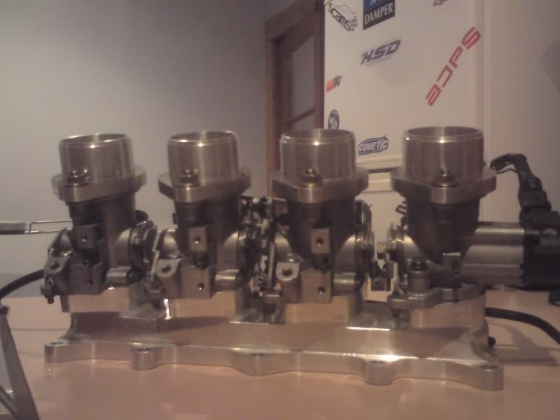

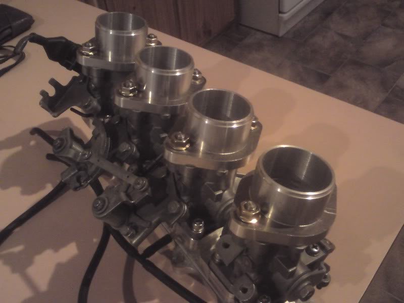

    Made a start on my intake plenum, had the 20v flanges CNC machined, making life easy!
    Turned up the runners on the lathe from 55mm solid round aluminium, couldnt get a close enough match
    in ally pipe.

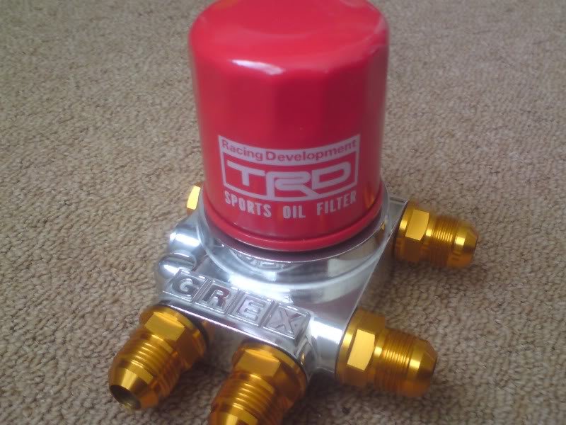

    Some of the goodies ordered the other week are arriving, remote oil filter mount with
    internal oil thermostate for the oil cooler
    TRD oil filter 110% wank factor

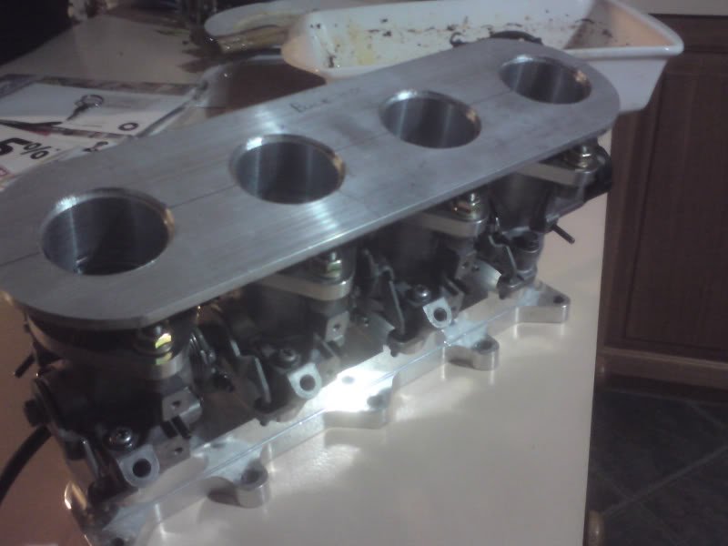

    With plenum are you going to use ally tube like a log or pressed plate box type?

    unsure of plenum design atm got lots of ideas swelling in my head!

    Update from a few weeks ago, should have the plenium complete soon been working in SA for a month

    Adding radius or bell mouth inside plenum too I hope?

    yeh mate got this sorted dont worry your pretty little heads haha
    Base plate hasnt beent welded to the throttles yet, I'll use a small radius trimmer on a router I recon
    next update plenium should hopefully be finished and a few new goodies
