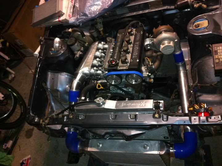

    intake plenum, intercooler and piping update

    Veteran Vance's Avatar
    Dan/Rio
    Randwick
    5,155
    hot looking engine bay
    Veteran joeschmo_57's Avatar
    Joe
    NT
    Nightcliff
    1,593
    yeah, that is a better bay than Wineglass.
    quit hatin get bakin!
    Joe
    Bellbowrie
    330
    i fucking love this build, hurry up and drive it so i can see vids of this thing!!!!!!! this car has made me want a gte more than ever!!

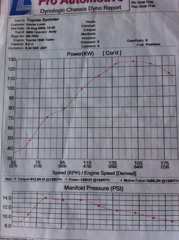

    Found the dyno sheet from the old engine, a lite 125 kw and 912Nm of tractive effort!
    Boost drop seemed to be holding it back from a better figure.
    Old Setup:
    Biport head and rwd manifold
    Small port AE92 4AGZE bottom end
    Td04 turbo
    Pretty sure the combo of the head and bottom end resulted in higher compression
