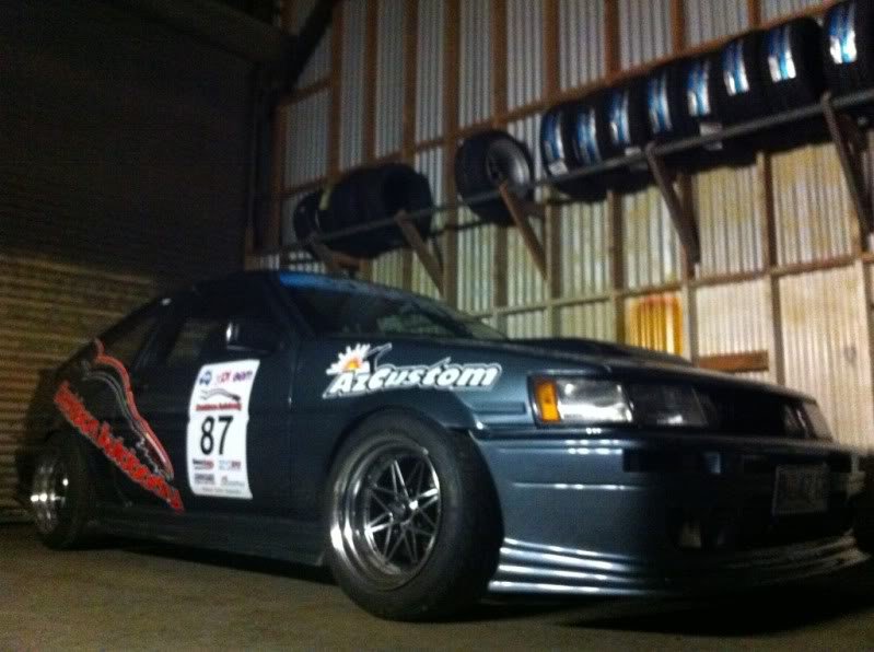

    Default Kierans 234kw 4AGTE Poward 86 BUILD COMPLETE!! (Tassie spec)
    Round coverage video by scott mitchell, sweeeeeet vid!

    Hey guys
    I made the change over to the martini racing E85, luckily enough for me that when I started building the 86 I had plans to use e85
    eventually, so my fuel lines, pumps and injectors were flow enough fuel and e85 compatible. I used Alphagomar flexforce6 hose with pushloc AN fittings, the only down side is
    I have the stock steel tank in place, which I'll have to replace very soon with a plastic fuel cell to prevent it being eaten away!!
    Friends of mine had been having trouble with fuel pumps dieing, E85 being ethanol based acts as a cleaning agent of sorts so we did a few little tests showed that if we put a bottle of wyns injector cleaner in with each tank of fuel it would provide some added lubrication to the fuel pumps.
    The car gained 40kw (260kw 8000rpm 20psi) and 100nm, its an animal now loving 3rd gear power skids also the exhaust fumes smell sweetly funky n all that jazz
    ae86:
    Im using an OS Giken twin plate, if feels great not heavy under pedal at all and very predictable, I bought it second and was a little skeptical as to how long it would last
    but seems to be loving life!
    FoldKing86:
    I wasnt aware of that, they seemed to bleed air in behind the throttle increasing the idle, just like a carby you could hear the adjustment? How should I have done it? I have the first gen silver top throttles with the twin linkage, apparently not very common?
