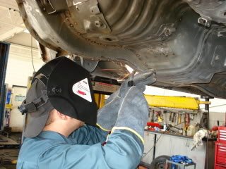

    some more pics
    had to cut out a piece of rust. just welded in a new peice of metal and filled it over. update the finish tomo
    some spot welding in the engine bay. this was my first time with a mig welder
    pretty much going over the whole car and spot welding everything.
    so far have only done underneath and the inside.

    don't know about farting. only bad splatters when i was welding underneath.
    it isnt hard to spot weld. this was my first time welding and 99.9% of my welds were on target and penetrated.
    preperatin is the key. make sure you take away all the paint were your welding, also a really good earth close to the weld. if you get these 2 points right you will be ok.
    i didn't take it back to paint on one weld, made a big ball which fell on my arm and exploded. i now have a nice burn all over my arm.
    ive spent a shit load of time on this so far. lost count of how many hours taken. includint completely stripping the car, degreasing, wire wheeling, preping for weld including removing all body sealant(including wheel arches) and welding itself prob bout just over 100 hours
