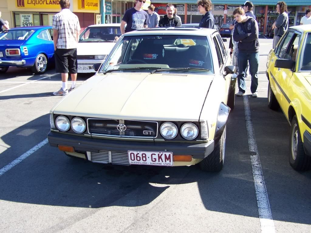

    My name's Andrew (or Ando as some refer to me - easy on the Heroes jokes), I'm one of the MADHOUSE proprietors and this is my little golden warrior. It's my daily and fun car most of the time, but I also have half share in a Silvertop 20V-engined Clubman with my dad which is the REAL touge car (grip, not drift). Maybe I'll put another member's ride thread up here one day, but I wouldn't hold your breath :lol:
    I bought my little beauty around 2 years ago from a guy in Coorparoo for a great price, who had bought it off another dude 10 months prior. I think he may have been a regular on RollaClub or Toymods way back in the day so some of you might know it. It needed a bit of a tidy up when I got her - I'm pretty fastidious about the way I present my cars, I like everything to be as neat as possible, but often times I find myself short on time and just end up shortcutting something. Guess that's the problem when you've got to drive to work on Monday. :blink: One day I'll get the time to take it off the road for a good amount of time and do a full rebuild from the ground up...
    So, enough blabbering and on to the car. Firstly a few pics so you know what I talking about (props to Hao (majic86) and SON57A for the pics). More to come incl. engine bay + interior pics when I get some time. :2thumbs:

    1982 Toyota Corolla KE70
    Engine:
    Full AW11 4AGZE conversion with all the fruit
    SC14 'charger from a 1GGZE running 9-10psi
    Wolf 3D V4 with hand controller
    Front-mount intercooler
    Extractors
    2 1/4" Overdiff exhaust with 2" tip :ph34r:
    K&N filter
    Splitfire plugs/Top Gun leads
    Kill switch
    1L surge tank (in boot)
    VL turbo fuel pump
    Battery box (in boot)
    Driveline:
    JDM T50
    Brass-button clutch (no-idea what type)
    Custom 2-piece tail-shaft
    T-series diff
    KAAZ 2-way LSD
    Suspension:
    Current Ghetto Setup:
    Monroe GT shockies
    King Springs Low
    Full SuperPro Polyurethane bush kit
    24mm (I think) adjustable rear swaybar
    AJPS Strut Brace
    On The Bench:
    T3 Camber-tops
    AE86 Custom coilover setup with Eibach 8kg/mm springs and KYB SR Special front inserts
    Brakes TBA (but huge...)
    TRD Green 8-way adj. rear shocks
    6kg/mm Springs (to be obtained)
    Rose-jointed LCA's
    MADHOUSE Adj. rose-jointed 4-link rear
    AE86 Steering Rack
    AE86 P/S arms
    Wheels:
    15 x 8 -4 Performance Superlites with charcoal center all-round; wearing
    195/45/R15 Federal SuperSport 595
    Body:
    Cut down plastic-spec bumpers
    Ghetto MARKE70 Honda quad-light conversion
    IPRA bolt-on flares
    JDM GT Badges
    MADHOUSE JDM lip (soon)
    Massive hole in the roof that someone's filled with a non-opening sunroof that STILL leaks
    RUST plus lots of sealant/silicone to stop the cancer spreading
    Interior:
    330mm Wheel (some Italian jobbie) with boss/spacer
    MOMO shifter
    Speco Oil Pressure, Oil Temp and Boost gauges in holder
    OBX Daytona Bucket on custom rail
    Fully-sick K&N Slip-on covers
    Old-school Alpine CD headunit
    Kenwood and Rockford Fosgate Amps
    JBL Splits
    Pov Radio-shack speakers on the parcel shelf in custom boxes
    10" Sub in the boot for the fully hEkTiC DoOf!! (Seriously though - ICE is definately not my thing, but the last guy put it all in. At least I have decent tunes...)
    Best thing about it - my girlfriend HATES it which tell's me that I'm on the right track :lol:

    Holy shit I sooo nearly bought this beast a few years ago.. Saw it in a car park one night out at brissie and thought it looked pretty tuff, hopped on the net the next day looking for what prices ke70's were going for and alas the car I was drooling over the night before was fs!!! Looked quite different to what it does now, and was running one of the very first wolf cpu's ever made(seriously it was like one of the first 3 trial versions of the V1) which is ultimately why I didn't buy it.
    The front mount is two RX-7 cores welded together I believe.
    Great to see where it's ended up.. Very tuff little car. Paint and general presentation looks MUCH better than way back when as well
    Yeah - luckily that got replaced with a V4 before I bought it. Not sure what happened with the original V1 but a replacement Microtech or similar is on the wishlist for later.
    Nice spot on the intercooler - you get a gold star
    When this was originally built back in the day there was no such thing as cheap Ebay/chinese 'coolers. I guess this was the "budget" alternative
