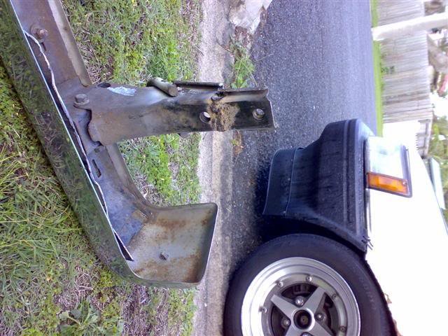

    hehe, its a nightmayre!
    heres some pics of how i did it
    using the stock ke70 brackets, and metal bumper part.
    hack the metal bumper part untill the T18 bar fits over it, and you can bolt through it.
    then you need to cut and shut the ke70 brackets, as they are too long.
    then you need to weld the brackets higher, to make it fit properly.
    it will make more sense in the pics

    If uyou nwant it tofit propperly use the ke70 brackets and modify them to the t18 brackets.... look at my thread how i did it.. yall
