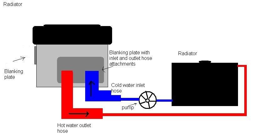

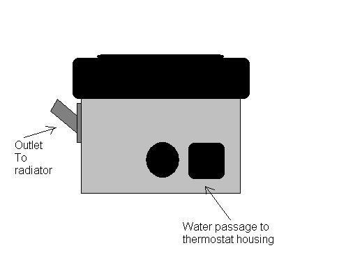

    Yep definitely will need hoses, pipes and what not. Although now that I think about it, I could probably just run the inlet and outlet hoses up to the blanking plate. Then I could blank off the original outlet house coming out of the head. If anyone can point out and flaws or improvements that'd be great.
    This is my crappy interpretation of the back of a 20V head.
    Now this is the setup I think would work... hopefully.

    <div class='quotetop'>QUOTE (Sam_Q @ Apr 6 2008, 10:23 PM) </div>Not sure if I'm quite following you. So you fit the pump to the bottom radiator outlet (cold water) then connect it to where? Because you said to blank the water pump and put a bypass plate at the back of the head, now there's only the small outlet pipe free.
    If I run the pipes to the back of the head as shown, won't this make it identical to the stock setup, whereby cool water enters through the head?
    As for taking the front half of the pump with the pulley off and fitting a blanking plate, is it possible to get a shorter accessories belt to suit?

    ok put a pipe that goes from the back of the water pump to the bottom radiator hose then put the electric water pump in the middle of that.
    block off the water oulet next to the exhuast flange
    fit a bypass plate to the back of the head to bypass the water from one opeing to the other.
    You could run external pipes but its a lot of screwing around
    you would be able to get a shorter belt no problems at all
    still want a functional heater?

    Yeah your way is definitely neater, but won't cold water run through the block first then up to the head passing the throttles and heating the intake air?

    indeed your right, however I believe that the real world difference might be pretty small. But I shouldnt say I as I have no conclusive proof
