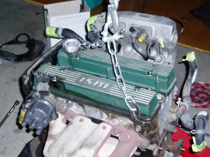

    I have myself a 4AGE with RS-YASU cam covers. Now the paint on them is fairly screwed as you can see in this photo:
    It would appear that oil attacks the paint they used, that coupled with the previous owner not being too careful where they poured the oil has resulted in a dirty motor and stuffed paint on the covers.
    My first question for those in know about paint. They originally used a textured paint and it looks pretty good, any idea where I might find such a paint, preferably in an oil resistant form?
    Second question for all those out there who are gurus in rare Japanese sprinter bits. Do you think it would be too heinous a crime to repaint them red? Just my car is red and I really don't like the combination of green and red. As far as I know they only ever came in green.

    this stuff is wrinkle finish, available in red and black, and grease resistant etc.

    powder coat them

    im with dylan. go the VHT wrinkle coat, used the black one on my cam covers. and is definately grease/oil resistant.

    oh, and for the paint, ive found that the heat resistant stuff at supercheap gives a bit of a course finish, i like it.

    VHT is crap compared to powdercoating. Id suggest powdercoating. They can do mettalics, wrinkle finish, hammer tone, whatever you want these days. Just make sure they dont get it on the mating surface.

    I've heard the trick to getting a good finish with the spray pack wrinkle paint is to warm the cam cover up in the oven before you spray them - not too hot though!

    to the original thread poster.best way is powder coat it . cost a bit more but the finish will be better and tougher. petrol,grease, and heat wont do shit to it .
