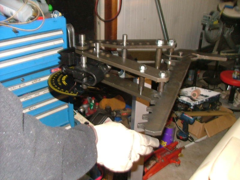

I would be interested in a picture of your bending machine, and the mandrel dies etc. Do you just have the mandrels for roll cage tube or a whole range of sizes? These machines can cost heaps.

its a jd2 manual benders, i only have two dies at the moment, 1 1/2 and 1 7/8. main sizes in tube for cages. you can get all size dies, dies for square too. but at 350-450 us dollars each itll be a while till i can get a few more.

where do you get a bender that can do 1-3/4inch ??
