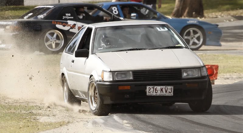

Hey guys,
Thought I'd share my ae86 with you all on the new forum.
It's come along way since I bought it, and I'm finally happen with the setup of the car for the first time ever! so I'm very excited to have something with a proper balance.

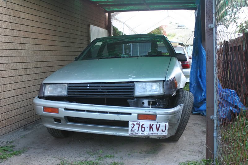

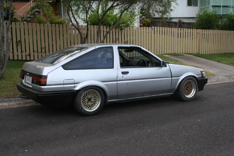

Earliest photo:
December 2007

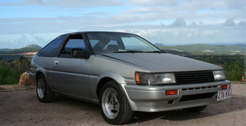

Most Recent:

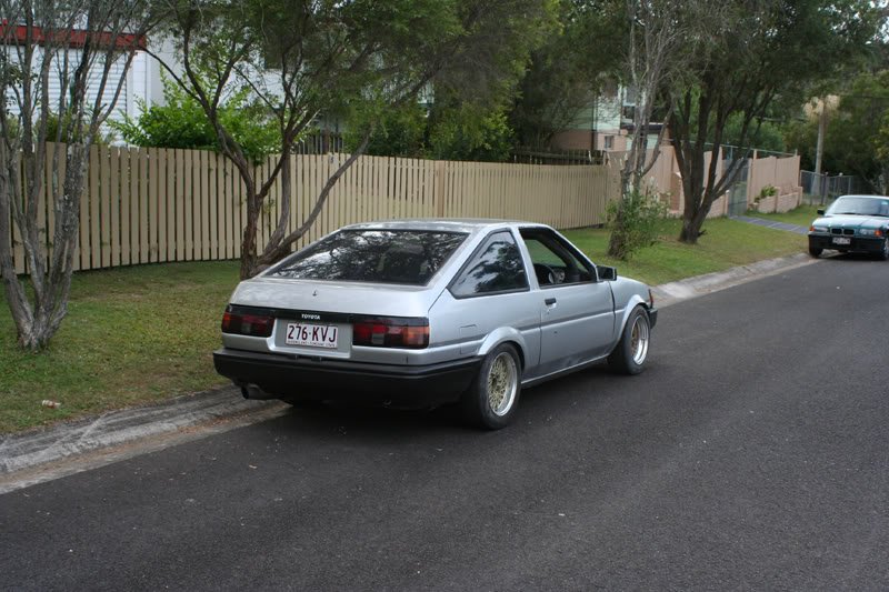

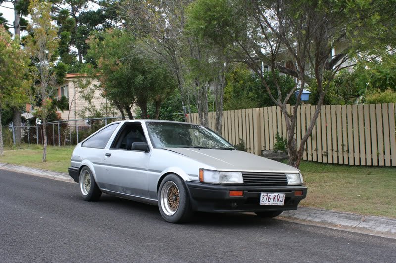

Mods include:
Stock 4agze
7kg/mm Front Coilovers 4kg/mm Rear Coilovers
JDM Front Brakes
Whiteline adjustable swaybars
Ultimate bracing front strut brace
Cusco Rear strut brace
JDM 7 Point roll cage
FRP front guards
14x6.5 SSR reverse mesh rims
New "heavy duty" Clutch
TRD 2 way LSD T-series diff

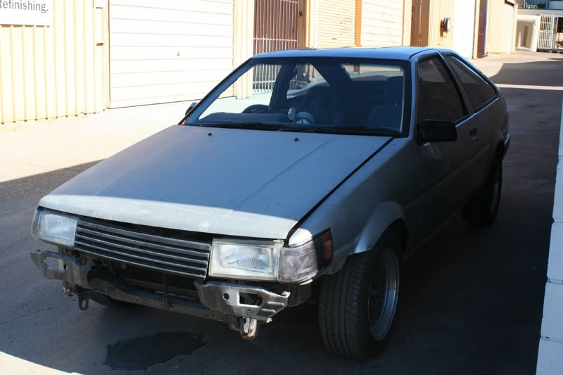

Life story with pics:

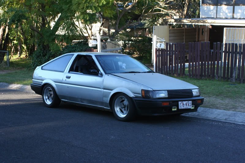

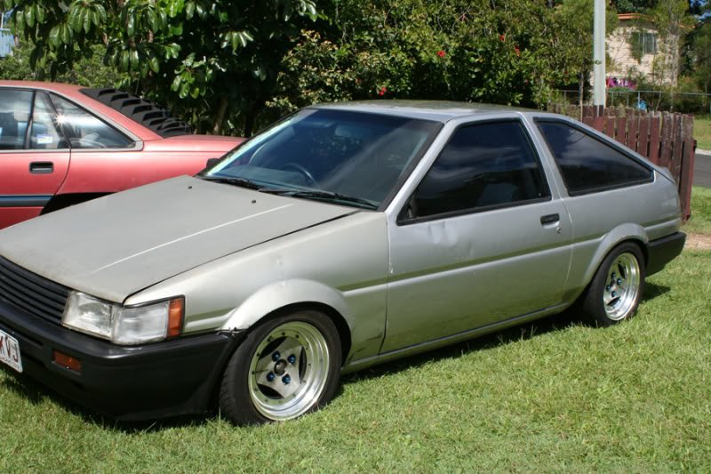

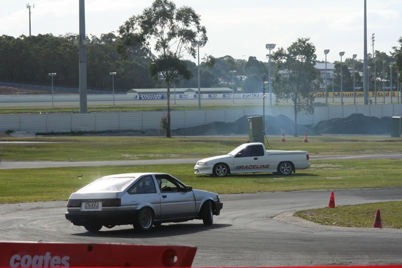

When I first got the car, it had king springs, a locked diff, and a 4agze. This setup was horribly unbalanced, it spun heaps and was very hard to control, especially considering I wasn't a very competent drifter either.
My lack of decent drift tyres didn't help either, and just made the setup worse.

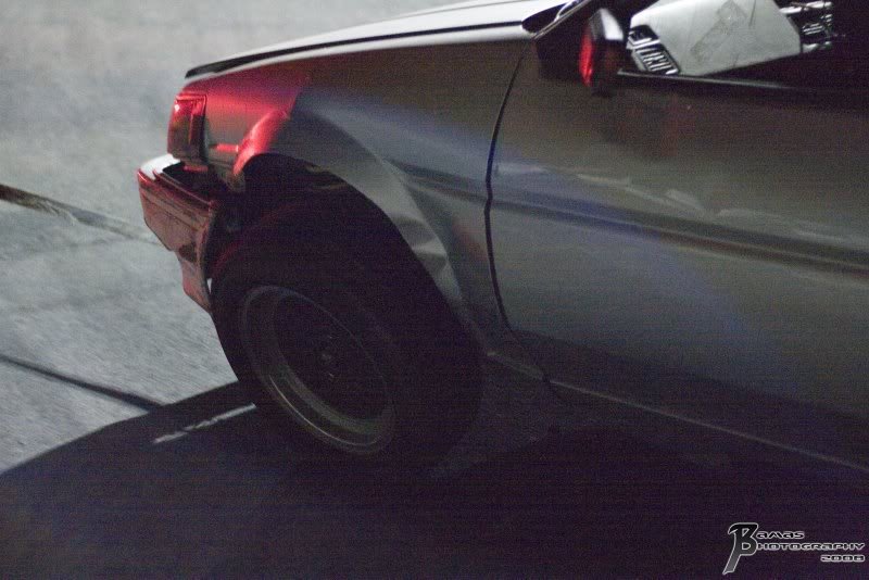

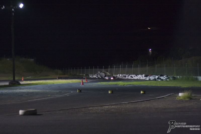

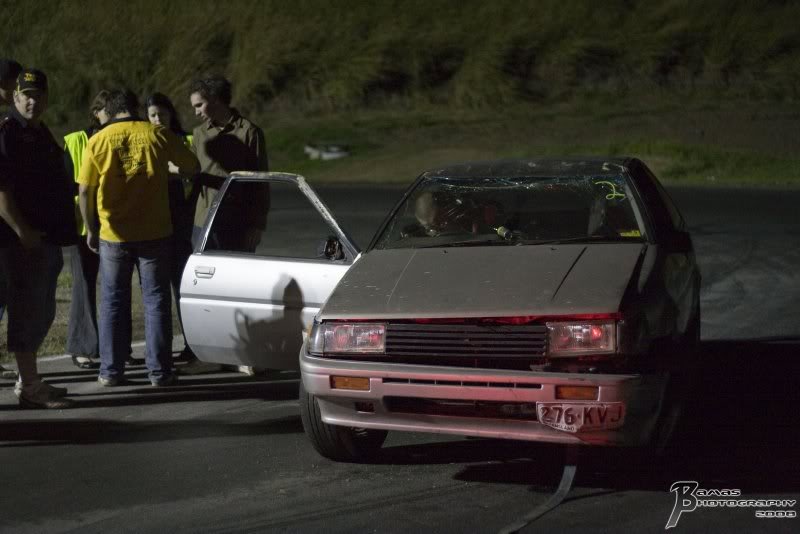

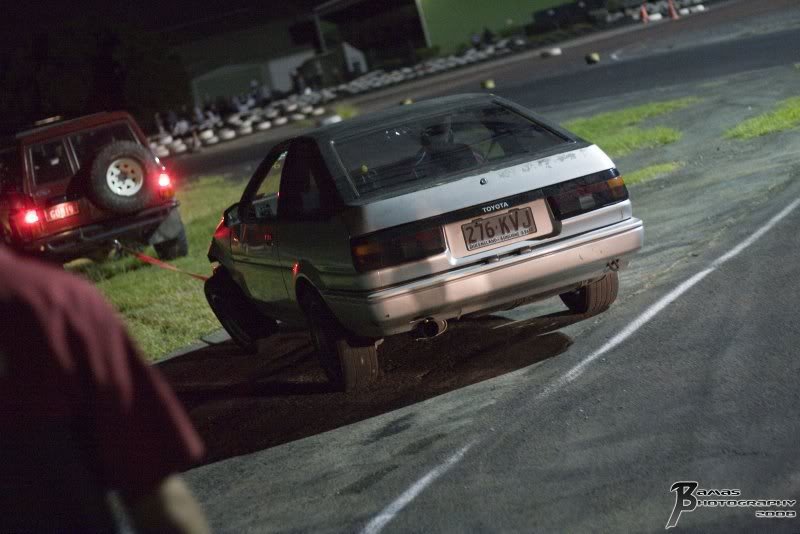

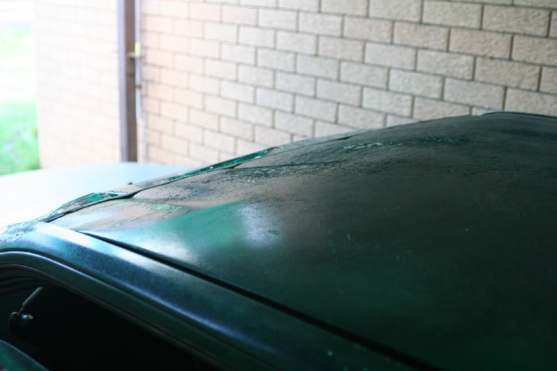

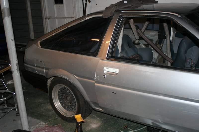

Then one night at Archerfield, this happened...

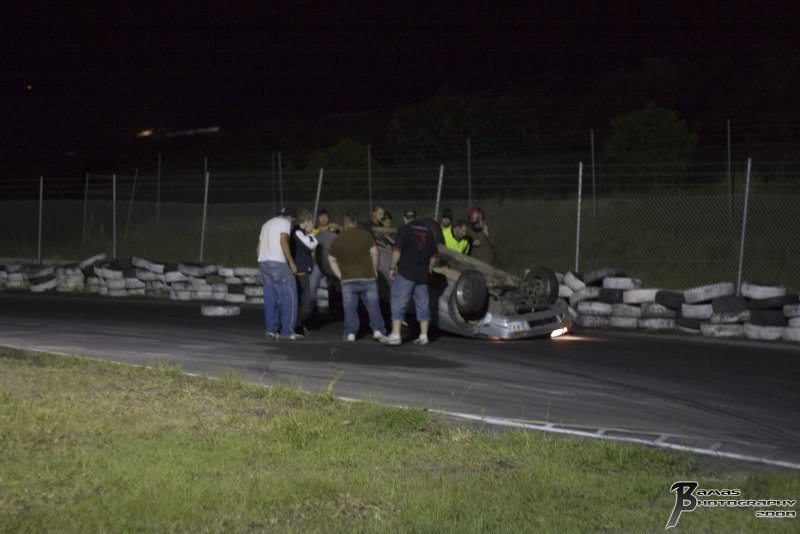

It was all pretty exciting, the car gripped up mid-drift as my rev's were too low, and I was still at full lock, so all of a sudden the car started heading towards the wall, and I only managed to straight the wheel enough to be facing parallel to the tyre wall, which may have made things worse. Rather then hitting them, the car climbed up the tyres, at fairly low speed, went up on to two wheels, then collapsed onto its side. eventually ever so slowly tipping onto the roof.

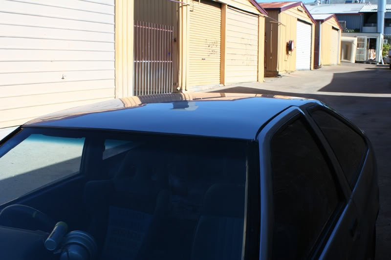

All and all the damage wasn't so bad, and was an easy fix.
And I got to get ugly roof coloured Silver at the same time!

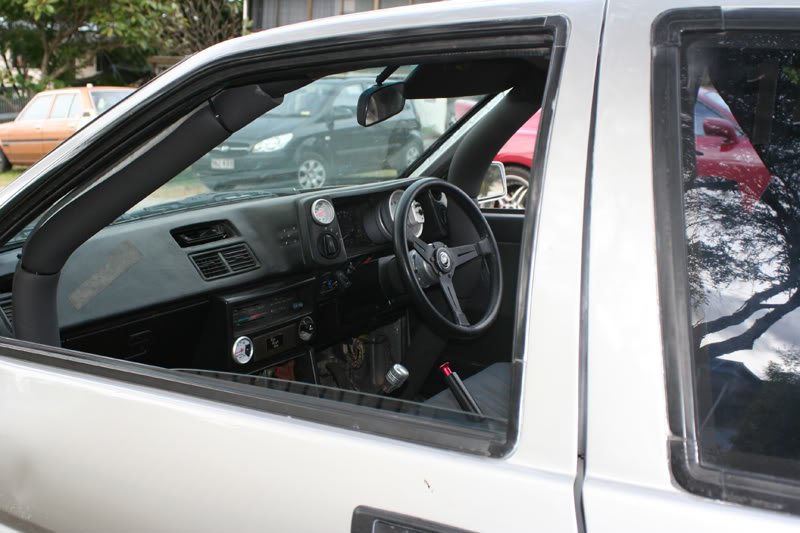

Just in case, I installed a full 7 point roll cage, which I actually ordered before this had happened!
The cars also suffered really badly from body roll, so while I was at it, I installed coilovers all round.
The JDM brakes are a more recent addition.

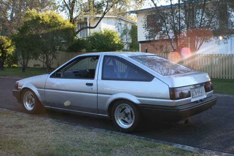

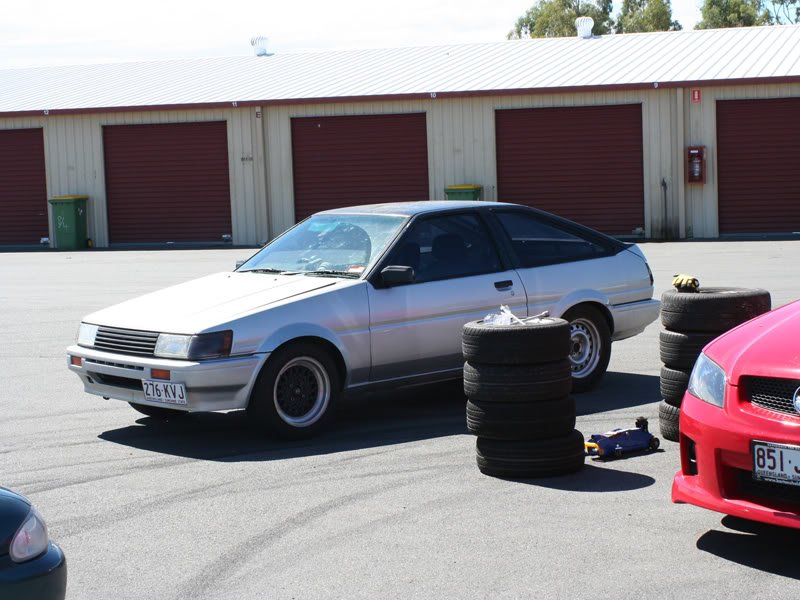

So the car was all sorted again, and ready to slide on the new coilovers.
I still seemed to struggle a lot to get the thing drifting, at least now I wasn't spinning so much thanks to the coilovers. Josh Young had a lap of it to see if he could give me some pointers, and after failing to be able to drift it either, we came to the conclusion that I needed a new clutch.

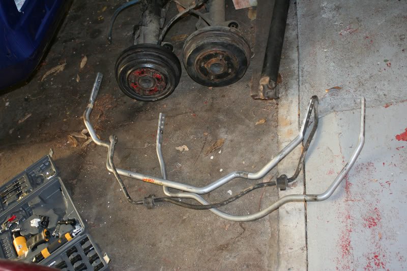

So a new clutch it was. I figured while I was pulling the driveline apart I might as well upgrade it. So I added in a TRD 2 way LSD as well, and to finish the car off, some sway bars!
I tried out some spacers too, but didn't really have much luck with them, so I canned that idea.

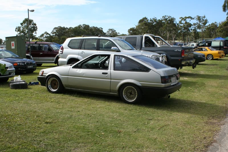

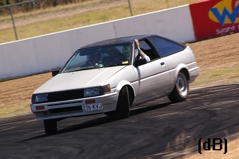

Now with the sway bars on, the 2 way LSD, a clutch that didn't slip and some proper tyres, all in the same size. the car was finally balanced. and once I turned the supercharger on, it was soo much easier to drift.
So off to parklands I want, and I was struggling at first, the setup felt worse then ever, and I felt like I had completely forgotten how to drive a car, it just wouldn't stop understeering. My brother pointed out to me that he couldn't hear my car at all when I was out there, and it hit me that my car didn't seem to have the same amount of power as I'd remembered. So I figured out which switch turned the supercharger on, and away I went.

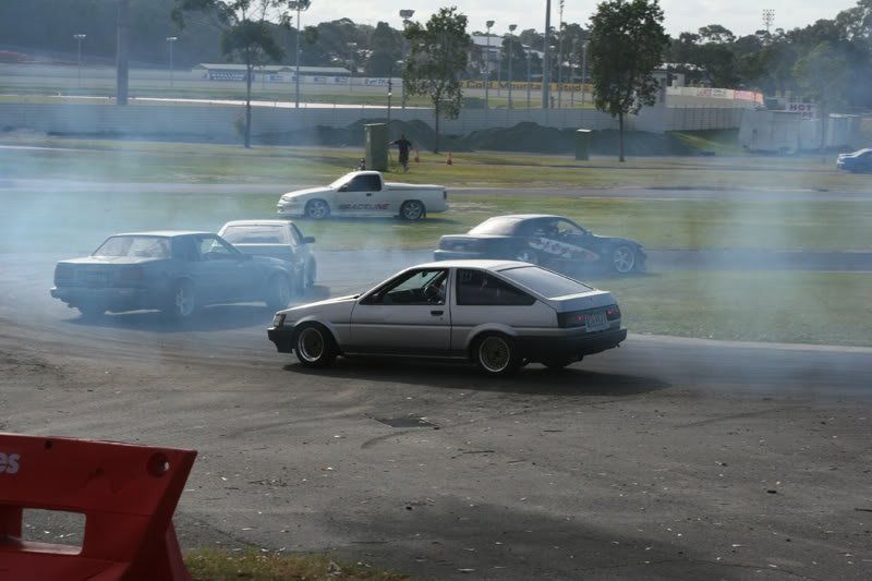

I was so confident with the setup now, I was happy to join in on the drift trains, even though before that day I would have never considered myself a confident drifter.
So that's pretty much it to date. The car is finally setup now the way I want it. So hopefully you'll see me much more regularly at local drift events.![]()
