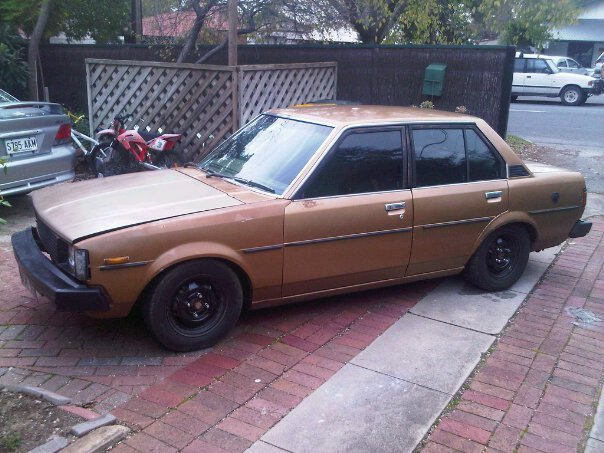

    Owned a daily ke70 for a couple years now and used to drift my old s13 until that went sour.
    Always wanted to build an SR ke70 but my shell was full of rust so i picked up this ke70 for $600 with no rust at all just a dented front right guard.

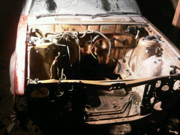

    got pretty much straight into it tore out all the interior
    then started some body work

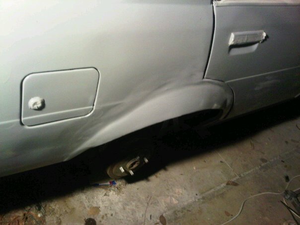

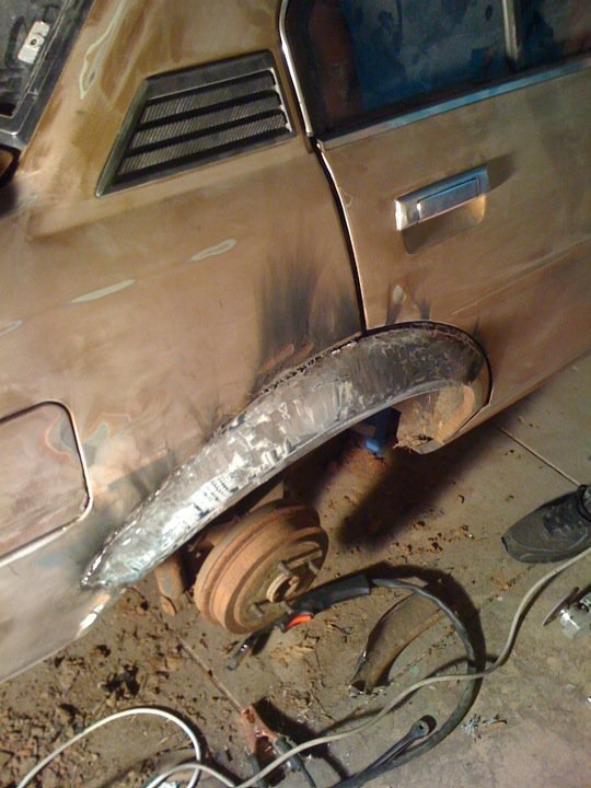

    i picked up some front guards and cut the flares out of them and cut the flares out of the rear and welded them on

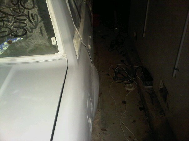

    bogged them up and sanded them back

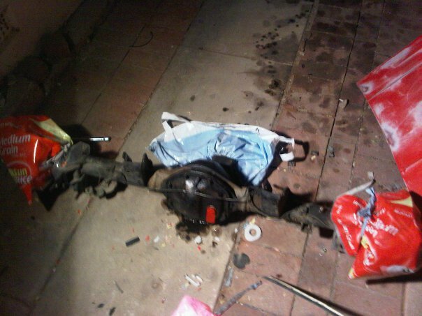

    picked up a 31 diff already mini spooled with 4:11 ratio
    sending that off to Boss Engineering to get modified and shortened 12mm in the next couple of days

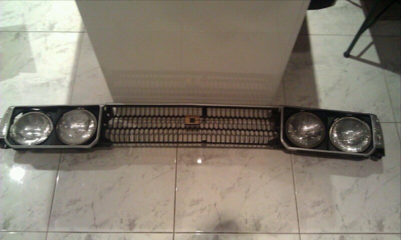

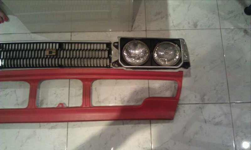

    and what every ke70 should have...............a pair of quad lights
    in the process of buying these

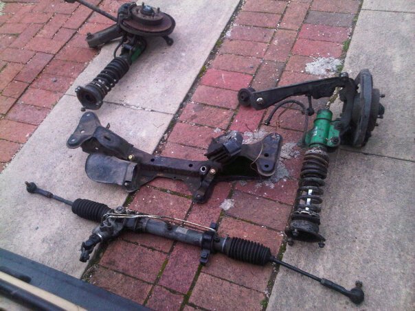

    Bought some s13 front suspension setup today

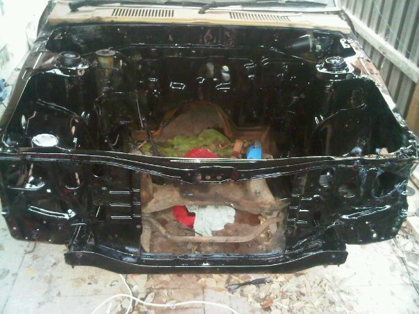

    also got around making the engine bay a little neater

    Dropped the 31 diff and KE diff off to Boss Engineering today to get the KE sleeves welded onto the 31 Centre so all the mounts mount up perfectly and also getting it shortened 12mm each end
