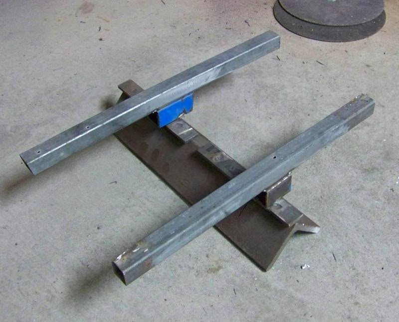

    with the work I have seen you do I am sure you could do it easy. I will take a picture of the tool I made to do a skyline housing

    here you go as promised:
    just a big chunk of angle with flats welded on. The flat sections allow the twin C-clamps on either side to be done up super tight. It's pictured upside down to how I sit it with half of either end of the chopped diff tube sitting in the V shape to hold it straight.
    With a bevel on the housing I do selective welds on both far outer edges equally before removing the clamps to grind the welds flush and rotate this support 90 degrees to weld it top to bottom. I use selective limited welding on opposing sides to stop it warping. End result was oil tight and dead straight. I also did the sneaky move of making the join end up in the middle of where the control arm mount would be welded on for extra strength.

    had to read that twice but now ive got it. seems like a nice simple way to do it.
    what i have seen before/planned to do was cut the weld of the wheel bearing "holder" on the end of the axle tube. shorten it there and weld it back on.
    someone suggested this might be the way to go as any mistake/misalignment you make is not amplified like when do it closer to the center.
    the hard part doing it that way though is not so much getting it square, but getting it concentric. not too sure how tight a fit that bearing housing is. luckily there are some pretty cheap wreckers around so if i botch it its not the end of the world.
