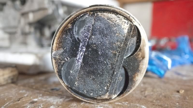

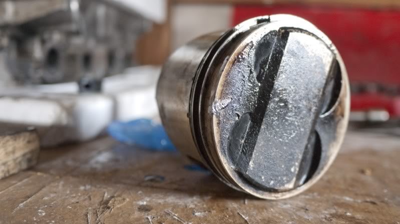

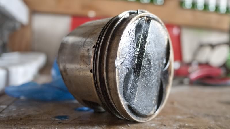

    As i suspected the bottom end had a nice set of Toda Pistons. Only Problem is piston 1 has a dent . My question. after a clean up , will this be re-useable ? what do you guys think would cause this sort of damage ? piston 1 .

    Nice find...
    If it's not an all out motor, just dress the high spots & crack test it.
    If that's all good, clean 'em up as they should be fine to go again.
    (Looks like FOD from a screw thread or something)
    How's the Ex quench pad on the head #1 ?
    I can get you a single piston if need be + rings, clips & pins are also available as sets or individual items.

    Toda man here has a good point, buying a single piston will probably be cheaper than dressing this one up and getting it cleaned and crack tested

    ps. yep i found the little bugger that did it stuck on the head. pictures to come . this may of been the reason for the knock. and not the bottom end bearing as first suspected.
